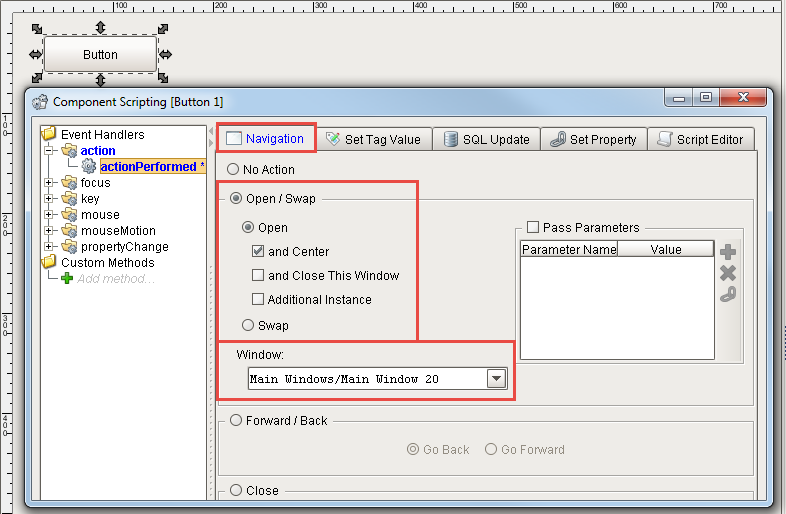

Open or Swap a Window with Scripting​
  1. In the Designer, right-click on a component and select Scripting.
    tip
    Usually a button is used to open a window.
  2. Select the appropriate Event Handler for the component.
    note
    Event Handlers are different for different components. There are a number of different options to choose from based on how and when you want your window to open or swap. If you are using a button, select the actionPerformed Event Handler.
  3. Select the Navigation tab.
  4. Click the Open/Swap radio button.
  5. Select either the Open/Swap radio button as your Navigation strategy. Typically, you want to use the Open option for Popup and Docked windows, and the Swap for the Main windows that will be in the background as you can only view one at a time.
  6. Select the Window you want to open/swap from of the Window dropdown.
    swapping vs opening step 6
