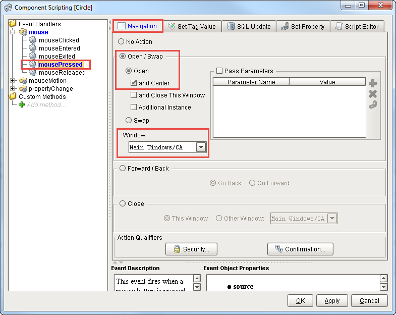

  2. Create a component such as a box, circle, star, etc., over an area on your image.
  3. Right click the component (box, circle, etc.,) and select Scripting.
  4. Select the mousePressed event handler, and with the Navigation tab selected:
    1. Select the Open/Swap radio button.
    2. From the Window drop-down box, select the window that relates to the selected area.
    3. Click OK.

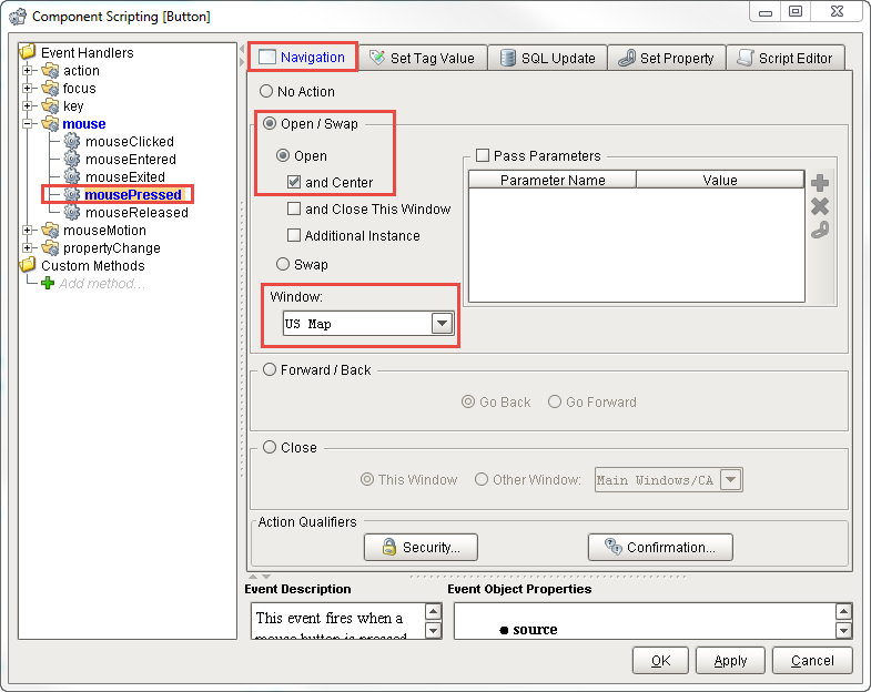

  6. On your area window, add a Button component to navigate you back to the main window (if you have multiple area windows, copy and paste this button to each window).
    1. Open your area window.
    2. Add a Button component.
    3. Right click on the Button component and select Scripting.
      Create Navigation Drill Down in Designer Step 6c
  7. Select the mousePressed event handler, and with the Navigation tab selected:
    2. From the Window drop-down box, select the window that is your overview map.
    3. Click OK.
      Create Navigation Drill Down in Designer Step 7c

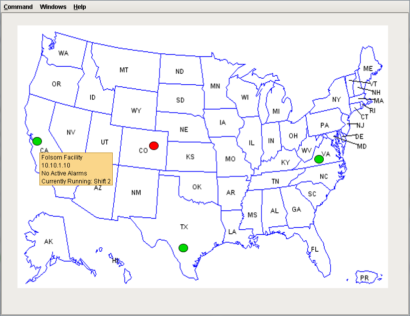

  10. Now, try it out! Open your Client, and click on your special shape to navigate to the area selected. You'll notice that in the following example the Mouseover Text property was used to display the location information when you hover over one of the circles.
    Drill Down Navigation with Mouseover Text

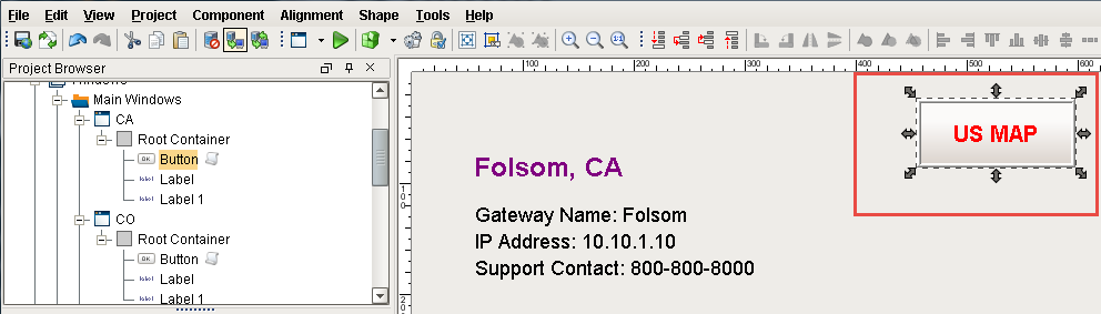

  11. Click on the US Map button to take you back to the US Map.
    Area Window with US Map Back Button
