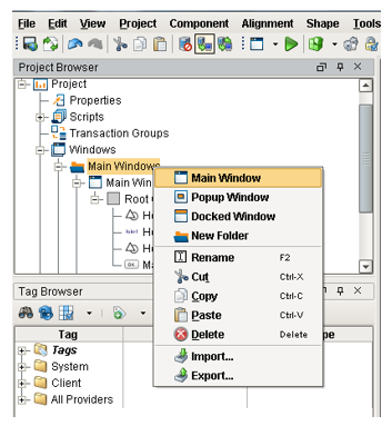

  1. In the Project Browser, right click on the Main Windows folder and select Main Window. You have the option of renaming your Main Window to whatever best describes your window. In this example, it’s called Main Window 1. You don’t need to have a header on each window, but for this example, a label was added for clarity and called Main Window 1. Repeat this step to create Main Window 2 and Main Window 3.
    Setting Up the Back and Forward Buttons Step 1

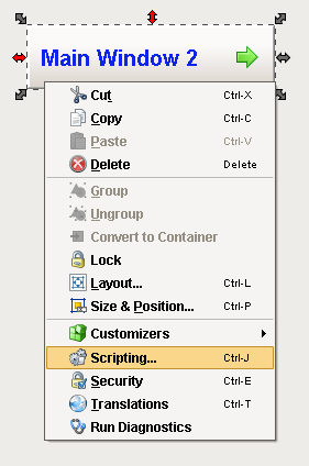

  3. Now you need to tell the Main Window 2 button what to do when someone clicks on it. Right click on the Main Window 2 button and select Scripting and the component scripting dialogue box will open.
    Setting Up the Back and Forward Buttons Step 3

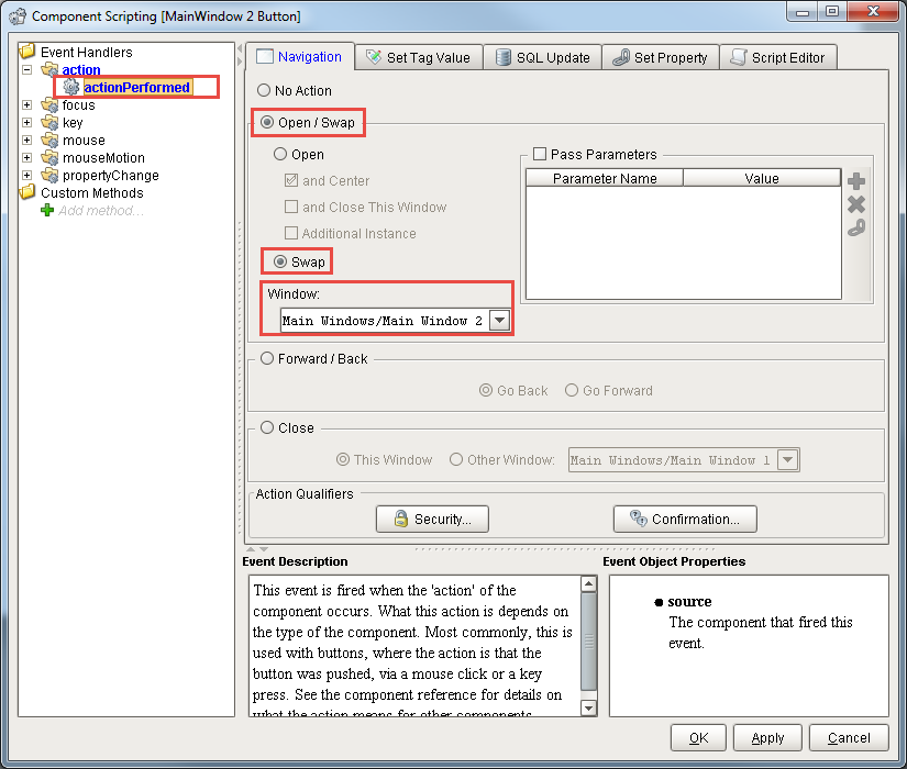

  4. Under the Event Handlers folder, open the action folder and select actionPerformed.
    1. Click the Open/Swap and Swap radio buttons. The Swapping function is used to put buttons on windows for easily building simple scripts to go back and forth between different main windows. The Swap function ensures only one main window is open at a time.
    2. From the Window dropdown box, select Main Windows/Main Window 2. Click OK.
      Setting Up the Back and Forward Buttons Step 4b

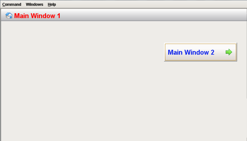

  6. Open your Client. Click on the Main Window 2 button and Ignition swaps the Main Window 1 with Main Window 2.
    Setting Up the Back and Forward Buttons Step 6
