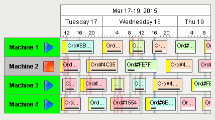

The equipment schedule view is a mix between the status chart, gantt chart, and a calendar view. It conveys a lot of information about equipment, including current status, production schedule, production status, scheduled and unexpected downtime.
The equipment schedule is powered by four datasets. Information is retrieved from the datasets by column name, case-insensitive. The order of the columns is not important. Optional columns may be omitted.
