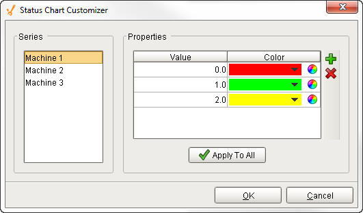

Customizers​
The Status Chart component has its own customizer, used to set a number-to-color mapping for each series in the Series Data property.
Status Chart Customizer​
PropertyDescription
SeriesSelectable list of all objects in the Series Data property.
  • Wide format: Each non-timestamp column.
  • Tall format: each unique value in the Name column.
Properties TableThe number-to-color mapping for the selected Series.
ValueA numeric value to match against.
ColorThe color to display for the given value.
Apply To AllSet all of the Series mappings to the currently selected mapping.
The Status Chart Customizer window. A Series list on the left holds Machine 1, Machine 2, and Machine 3, with Machine 1 selected. The Properties table on the right maps the selected series' values to colors: 0.0 to red, 1.0 to green, and 2.0 to yellow. Green plus and red X icons add and remove mappings, and an Apply To All button sits below the table, with OK and Cancel at the bottom of the window.

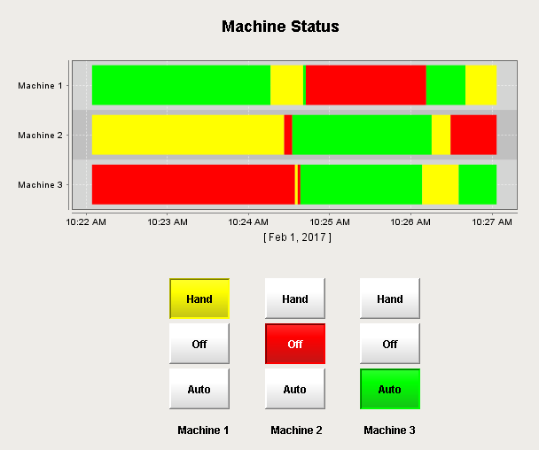

Examples​
This example uses the Status Chart to display the state of each of the three machines over the last 5 minutes. Tag History was turned on to record history HOA values. The Series Data property's dataset populates the Status Chart using a Tag History Binding. You can view the raw data by clicking on the Dataset Viewer icon to the right of the Series Data property. Each color represents a state for the machine.
A window titled "Machine Status" containing a Status Chart of Machine 1, Machine 2, and Machine 3 over five minutes, from 10:22 AM to 10:27 AM on Feb 1, 2017. Each machine's row is a band of red, yellow, and green segments recording its HOA state over time. Below the chart, three columns of Hand, Off, and Auto buttons, one column per machine, show each machine's current state highlighted: Hand in yellow for Machine 1, Off in red for Machine 2, and Auto in green for Machine 3.

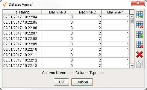

Series Data - Dataset Viewer​
The Dataset Viewer window showing the Series Data in wide format: a t_stamp column of one-second timestamps starting at 02/01/2017 10:22:04, followed by a Machine 3, Machine 2, and Machine 1 column holding the numeric state of each machine at that timestamp.

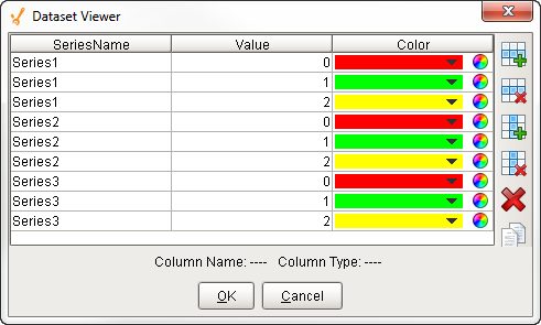

Series Properties Data - Dataset Viewer​
Each machine has three states, and each of the three states (i.e., HOA) have different colors assigned representing a different state.
The Dataset Viewer window showing the Series Properties Data, with SeriesName, Value, and Color columns. Series1, Series2, and Series3 each have three rows mapping value 0 to red, 1 to green, and 2 to yellow.
