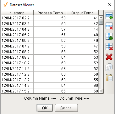

The default configuration of the component expects a dataset where the first column is a timestamp (the first column always acts as the domain for the chart), and sequential columns are pens that should be drawn on the chart. The default dataset contains a t_stamp column with values for the domain, and two columns (Process Temp and Output Temp) with values that will be drawn against the range.

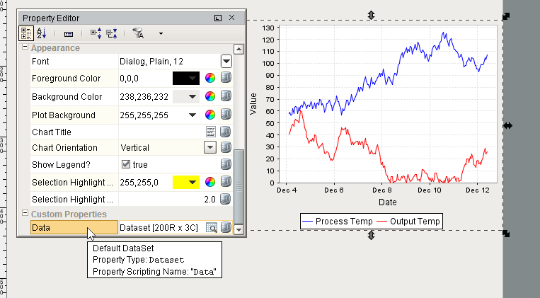

The Classic Chart is initially configured in a manner that easily displays Tag History with a Tag History Binding.
  1. Create a new Chart component.
  2. Locate the Data property. It should be located at the bottom of the Property Editor when sorted by section. Click the binding button.
  3. Select Tag History from the Tag section of the Binding window. Browse the Available Historical Tags, and drag them to the Selected Historical Tags table on the right of the window.
  4. Change the Date Range to Realtime with a Most Recent set to 10 minutes. Click the OK button.
The Chart will now show Tag History from the Tags you selected. Note that the timestamp has automatically been included as the first column, so the domain has been automatically configured for us. If you wish to change the orientation of the axes, then the Chart Orientation property in the Property Editor will swap the position of the Domain and Range axes.

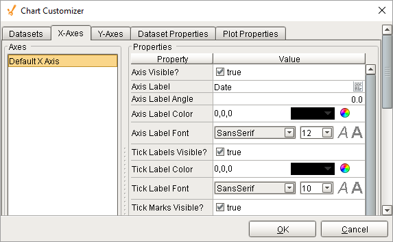

Once trends are present on the chart, additional customization can be achieved through the Chart Customizer. When you open the customizer, you'll notice five tabs at the top: Dataset, X-Axes, Y-Axes, Dataset Properties, and Plot Properties. Each tab has its own set of properties and defaults.
An overview of each section in the Chart Customizer is listed below:
  • Datasets: Allows additional datasets to be added to the component. Each dataset will appear as a separate custom property on the component. Data from multiple charts can be drawn on the same chart.
  • X-Axes and Y-Axes: Allows for the creation of new X and Y Axes on the chart. There are six types of axes to choose from when configuring a chart, each having its own list of properties: Number Axis, Date Axis, Category Axis, Logarithmic Axis, Elapsed Axis, and Symbols Axis. Most of the X and Y axes properties are used in the customizer, and some properties are specific to the axis type and have their own unique properties. See the Chart Customizer page for more information on types of axis, associated properties, and examples.
  • Dataset Properties: Specify which axes should a be used with each dataset. Also allows you to specify which subplot each dataset should be shown on.
  • Plot Properties: Configure the look of each plot.

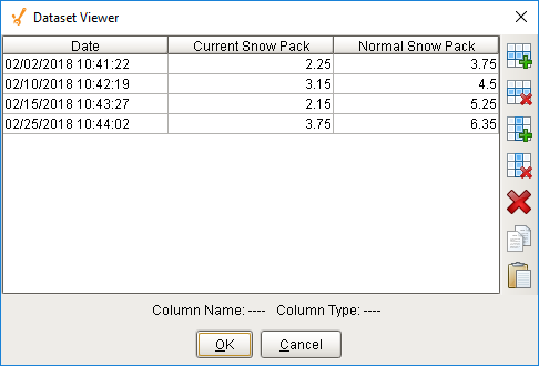

This example walks you through adding a new dataset to a chart, and modifying the existing chart properties using the Chart Customizer. When you first drag a chart to your window, you'll notice that it will display some data, that's because it's using the default dataset provided. For this example, you can add a new dataset by either copying and pasting the one below, or adding your own.
  1. Let's add a new dataset (i.e., SnowPackData) that measures the Snow Pack Level for the month of February. Double click on the chart to open the Chart Customizer. Go to the Datasets tab and add () a new dataset.
Classic Chart - SnowPack Dataset
"#NAMES"
"Date","Current Snow Pack","Normal Snow Pack"
"#TYPES"
"date","F","F"
"#ROWS","4"
"2018-02-02 10:41:22","2.25","3.75"
"2018-02-10 10:42:19","3.15","4.5"
"2018-02-15 10:43:27","2.15","5.25"
"2018-02-25 10:44:02","3.75","6.35"

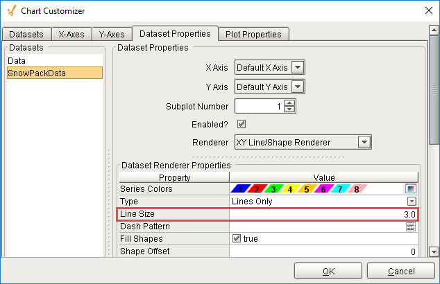

  1. Once you add your dataset, the chart will show the data from the default Dataset and your new dataset, so let's disable the default dataset by going to the Dataset Properties tab, selecting the default dataset (i.e., Data) and unchecking the Enabled? box. You'll notice the chart is now only displaying the values for the new dataset (i.e., SnowPackData).
  2. This example uses the default Number Axis type, but if you want to add a new Axis Type, go the X and Y Axes tabs and select a new Axis type.

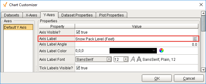

  3. Next, let's change a few visual properties on our chart. Go to the Y-Axes tab and select Default Y Axis, and change the Axis Label (i.e, Snow Pack Level (Feet)).

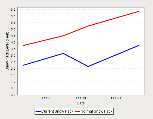

  4. Lastly, let's make the plot lines thicker on the chart. Go to the Dataset Properties tab, and change the Line Size renderer property from 1.0 to 3. 0.
  5. Here is the chart with the new dataset and updated properties. As you can see, you can easily configure additional properties for a dataset, as well as choose from a host of visual style properties to design your charts using the Chart Customizer.

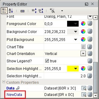

  1. Open the Chart Customizer: either double click on the chart or right-click and select Customizers > Chart Customizer.
  2. Once the Chart Customizer is open, make sure the Datasets tab is selected, and click the add icon to add a new dataset.
  3. A new row will appear. Give the new dataset a name by typing into the cell under the Name column. We'll call it NewData. Click the OK button.
  4. Check the bottom of the Property Editor. The newly created dataset will appear and may now be populated with data.
  5. Now that we have a new dataset, you can add data however you like and it will show up in a second subplot.
