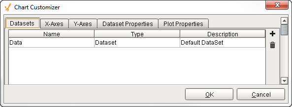

Datasets Tab​
The Dataset tab is where you set up, add, and remove datasets.
The Datasets tab of the Chart Customizer, showing a table with Name, Type, and Description columns and one row: a dataset named Data of type Dataset, described as "Default DataSet". Plus and trash-can icons for adding and deleting datasets sit to the right of the table.
PropertyDescription
DataDefault dataset property.
Plus icon AddAdds a new dataset. Click the plus icon a new row will be added. Enter the dataset Name and Description.
Trash can icon DeleteDeletes an existing dataset. Click the Delete icon to delete an existing dataset.
NameName of the dataset. Double click in the field to rename the dataset.
TypeDefault type is "Dataset."
DescriptionDescribes the dataset.

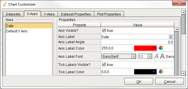

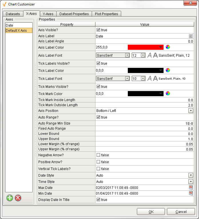

X-Axes Tab​
The X-Axes tab is where X-Axis properties are configured. You can also add and delete X axes here.
The X-Axes tab of the Chart Customizer, expanded to show the full Properties table. The Axes panel on the left lists Date and Default X Axis, with green plus and red delete icons beneath it. The Properties table on the right lists every X-axis setting with its current value, from Axis Visible, Axis Label, and the label and tick font and color settings, through Axis Position, Auto Range and its bounds and margins, the Negative and Positive Arrow and Vertical Tick Labels checkboxes, and the date-specific Date Style, Time Style, Max Date, Min Date, and Display Date In Title settings.
PropertyDescriptionSupport Axes Types

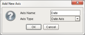

Green plus iconAdd X axis. When you add an X axis, you can select from one of the following axis types: Number, Date, Category, Logarithmic, Elapsed, and Symbol.
Click the green plus icon, select an Axis Type, enter an Axis Name, and click OK.
The Add New Axis dialog, with an Axis Name field set to "Date", an Axis Type dropdown set to "Date Axis", and OK and Cancel buttons.
All
Red X delete iconDelete an existing axis. Select the axis, and click the Delete icon.All
Axis VisibleIf false, the axis will be hidden.All
Axis LabelName of the axis.All
Axis Label AngleAngle of the value on the axis label.All
Axis Label ColorColor of axis label.All
Axis Label FontFont type and size of text on axis label.All
Tick Labels VisibleIf false, the tick labels will be hidden.All
Tick Label ColorColor of tick labels.All
Tick Label FontFont type and size of text on tick labels.All
Tick Marks VisibleIf false, the tick marks will be hidden.All
Tick Mark ColorColor of tick marks.All
Tick Mark Inside LengthLength of tick marks inside the chart.All
Tick Mark Outside LengthLength of tick marks outside the chart.All
Axis PositionDepends on the axis selected. X-axis label alternates between top and bottom. Y-axis label alternates between left and right. You many need to change both X and Y axis properties to get your intended axis position.All
Auto RangeIf true, the value axis range will be determined automatically. If false, the specified Lower and Upper bounds will be used.All
Auto Range Min SizeIf true, the minimum value range is used.Date, Number, Logarithmic, Symbol, Elapsed
Fixed Auto RangeSets an axis up for dynamic graphs.Date, Number, Logarithmic, Symbol, Elapsed
Lower BoundLower bound value. Used only when Auto Range is false.Date, Number, Logarithmic, Symbol, Elapsed
Upper BoundUpper bound value. Used only when Auto Range is false.Date, Number, Logarithmic, Symbol, Elapsed
Lower Margin (% of range)Lower margin represented as a percentage. Used only when Auto Range is true.Date, Number, Logarithmic, Symbol, Elapsed
Upper Margin (% of range)Upper margin represented as a percentage. Used only when the Auto Range is true.Date, Number, Logarithmic, Symbol, Elapsed
Negative ArrowIf true, negative arrow is visible.Date, Number, Logarithmic, Symbol, Elapsed
Positive ArrowIf true, positive arrow is visible.Date, Number, Logarithmic, Symbol, Elapsed
Vertical Tick LabelsVertical orientation for tick labels.Date, Number, Logarithmic, Symbol, Elapsed
Auto Range Includes ZeroIf true, the range includes a zero.Date, Number, Logarithmic, Symbol, Elapsed
Auto Range Sticky ZeroIf true, the zero is on both the XY axes.Date, Number, Logarithmic, Symbol, Elapsed
Number Format OverrideOverwrites the current number format.Date, Number, Logarithmic, Symbol
Date StyleThe style of the date displayed on the axis.Date
Time StyleThe style of the time displayed on the axis.Date
Max DateMax value in a series of dates.Date
Min DateMin value in a series of dates.Date
Display Date in TitleIf true, the date will be displayed in the title when the range is zoomed into the hour range.Date
Label AngleThe angle for the value axis labels.Category
"1e#"-style tick labelsIf true, uses scientific notation format (i.e.,1e5, 1e6, etc.,).Logarithmic
"10^n"-style tick labelsIf true, uses power notation format (i.e., 10 to the "X" power).Logarithmic
Symbols StringSequence of characters such as a literal constant. (i.e., On,Off,Auto)Symbols
Grid Bands VisibleIf true, grid bands will be hidden.Symbols
Grid Bands ColorColor of grid bands.Symbols
Grid Bands Alternate ColorBackup color of grid bands.Symbols
Format StringSpecified sequence of characters.Elapsed

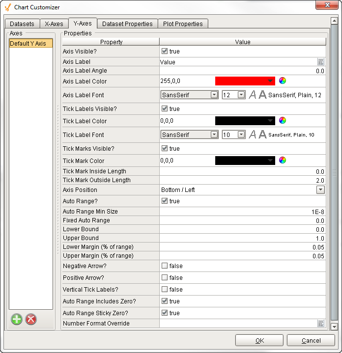

Y-Axes Tab​
The Y-Axes tab is where Y-Axis properties are configured. You can also add and delete Y axes here.
The Y-Axes tab of the Chart Customizer, expanded to show the full Properties table. The Axes panel on the left lists a single Default Y Axis, with green plus and red delete icons beneath it. The Properties table on the right lists every Y-axis setting with its current value, from Axis Visible and an Axis Label of "Value" through the label and tick font and color settings, Axis Position, Auto Range and its bounds and margins, the Negative and Positive Arrow and Vertical Tick Labels checkboxes, Auto Range Includes Zero, Auto Range Sticky Zero, and Number Format Override.

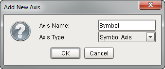

Green plus iconAdd axis. When you add a Y axis, you can select from one of the following axis types: Number, Date, Category, Logarithmic, Elapsed, and Symbol.
The Add New Axis dialog, with an Axis Name field set to "Symbol", an Axis Type dropdown set to "Symbol Axis", and OK and Cancel buttons.
All
Red X delete iconDelete an existing axis. Select an axis, and click the Delete icon.All

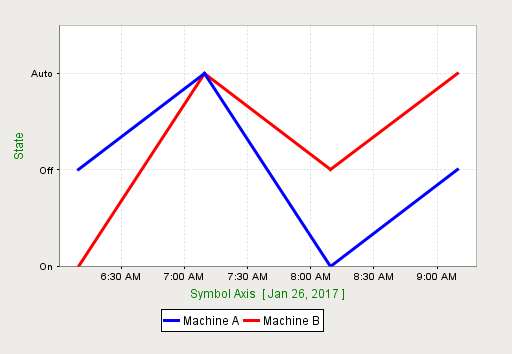

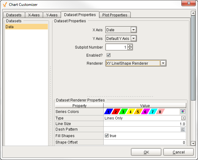

Dataset Properties Tab​
The Dataset tab is where you can modify the visual styles of your chart. You can configure your chart with subplots, experiment with different renderer types and property types to change how the data is displayed until you find what best meets your requirements.
note
Not all Renderer properties are available for each axis type.
The Dataset Properties tab of the Chart Customizer. The Datasets panel on the left lists the Data dataset. The Dataset Properties panel on the right sets X Axis to Date, Y Axis to Default Y Axis, Subplot Number to 1, Enabled checked, and Renderer to XY Line/Shape Renderer. A Dataset Renderer Properties table below it shows Series Colors as an ordered strip of eight numbered color swatches, Type set to Lines Only, Line Size 1.0, an empty Dash Pattern, Fill Shapes checked, and Shape Offset 0.
DatasetCollection of data in tabular form. Data from the dataset drives the chart.All
X AxisHorizontal axis.All
Y AxisVertical axis.All
Subplot NumberNumber of plot areas on one chart.All
EnabledIf true, the chart is displayed with the selected renderer properties.All
RendererThe visual style of the data presented on the chart. Select from various renderer styles:
  • XY Line/Shape Renderer
  • XY Bar Renderer
  • XY Area Renderer
  • XY Step Renderer
  • XY Step Area Renderer
  • XY Dot Renderer
  • Category Line/Shape Renderer
  • Category Bar Renderer
All
Series ColorsAn ordered list of the colors to draw series in.All
TypeType of XY Item Renderer.All
Line SizeThe thickness of the line.All
Dash PatternThe pattern used for dashed lines.All
Fill ShapesIf false, there is only an outline of the shape, no fill color.All
Shape OffsetThe offset into the standard shape list to start this renderer at. Offset values and respective values are listed below.
  • 0 - Square
  • 1 - Circle
  • 2 - Upward triangle
  • 3 - Diamond
  • 4 - Horizontal rectangle
  • 5 - Downward triangle
  • 6 - Horizontal ellipse
  • 7 - Rightward triangle
  • 8 - Vertical rectangle
  • 9 - Leftward triangle
Offset
MarginThe percentage by which the bars are trimmed using the XY Bar Renderer.All
ShadowsIf true, draws shadows under the bars using the XY Bar Renderer.All
OutlineIf true, draws an outline around the area using the XY Area Renderer.All
Draw LinesIf true, lines will be drawn to connect the datapoints using the Category Line/Shape Renderer.All
Draw ShapesIf true, shapes will be drawn to connect each datapoint if using the Category Line/Shape Renderer.All

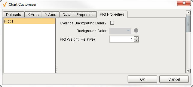

Plot Properties Tab​
The Plot Properties tab allows you to break up the chart plot area into multiple distinct subplots.
The Plot Properties tab of the Chart Customizer. A list on the left holds a single entry, Plot 1. The panel on the right shows an unchecked Override Background Color checkbox, a grayed-out Background Color picker, and Plot Weight (Relative) set to 1.
PropertyDescriptionAxes Types Supports
PlotThe chart area displaying data.All
Override Background ColorIf enabled, allows you to change the background color.All
Background ColorBackground color of the chart.All
Plot Weight (Relative)The chart ratio between subplots.All

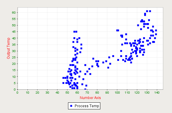

Number Axis Chart​
A scatter chart plotting the Process Temp series as blue square markers with no connecting lines. The X axis is a number axis labeled "Number Axis" in red running from 0 to 140, and the Y axis is labeled "Output Temp" in red running from 0 to 60. Tick labels on both axes are green, and a legend below the plot names the Process Temp series.
Binding Type​
  • Tag - Tag History
Chart Customizer Property Settings​
Datasets Tab
Property NameValue
DatasetsData
X-Axes Tab
Property NameValue
AxesNumber
X Axis LabelNumber Axis
Axis Label ColorRed
Tick Label ColorGreen
Y-Axes Tab
Property NameValue
AxesDefault Y Axis
Y Axis LabelOutput Temp
Axis Label ColorRed
Property NameValue
X AxisNumber
Y AxisDefault Y Axis
RendererXY Line/Shape Renderer
TypeShapes Only

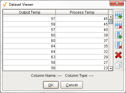

Dataset Property Dataset​
The Dataset Viewer window showing the dataset behind the Number Axis chart: two numeric columns, Output Temp and Process Temp, with rows such as 57 and 45, 59 and 45, and 57 and 40.

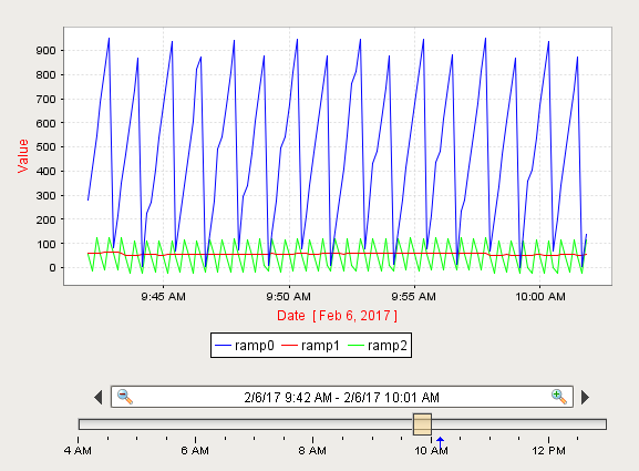

Date Axis Chart​
A timeseries chart with a Value Y axis from 0 to 900 and a red-labeled "Date" X axis spanning 9:42 AM to 10:01 AM on Feb 6, 2017. Three sawtooth line series, ramp0 in black, ramp1 in red, and ramp2 in green, repeat across the range, with a legend below the plot. Beneath the chart are a date range selector reading "2/6/17 9:42 AM - 2/6/17 10:01 AM" and a time-range slider spanning 4 AM to 12 PM.
Datasets Tab
Property NameValue
DatasetsData
X-Axes Tab
Property NameValue
AxesDate
Axis LabelDate
Axis Label ColorRed
Y-Axes Tab
Property NameValue
AxesDefault Y Axis
Axis LabelValue
Axis Label ColorRed
Property NameValue
DatasetsData
X AxisDate
TypeLines Only

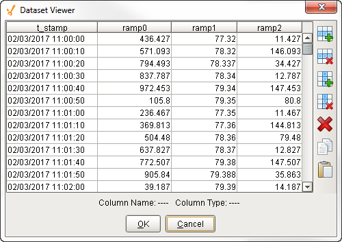

The Dataset Viewer window showing the dataset behind the Date Axis chart: a t_stamp column of timestamps at ten-second intervals starting at 02/03/2017 11:00:00, followed by numeric ramp0, ramp1, and ramp2 columns.

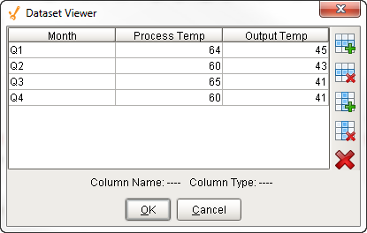

The Dataset Viewer window showing the dataset behind the Category Axis chart: a Month column holding the category names Q1 through Q4, plus Process Temp and Output Temp value columns with rows 64 and 45, 60 and 43, 65 and 41, and 60 and 41.

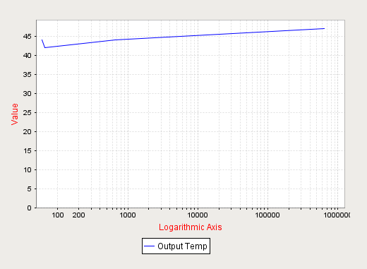

Logarithmic Axis Chart​
A line chart with a Value Y axis from 0 to 45 and a red-labeled "Logarithmic Axis" X axis whose tick labels step by powers of ten from 100 to 1000000. The single Output Temp series rises gently from about 42 to 47 across the log scale, and a legend below the plot names the series.
Datasets Tab
Property NameValue
DatasetsData
X-Axes Tab
Property NameValue
AxesLogarithmic
Axis LabelLogarithmic Axis
Axis Label ColorRed
Y-Axes Tab
Property NameValue
AxesDefault Y Axis
Axis LabelValue
Axis Label ColorRed
Property NameValue
DatasetsData
X AxisLogarithmic
TypeLines Only

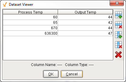

The Dataset Viewer window showing the dataset behind the Logarithmic Axis chart: a Process Temp column with the widely spaced values 60, 65, 670, and 636300, and an Output Temp column with the values 44, 42, 44, and 47.
Symbols Axis Chart​
A line chart whose Y axis is a symbol axis labeled "State" in green, with tick labels reading On, Off, and Auto in place of numbers. The X axis is labeled "Symbol Axis" in green and spans 6:30 AM to 9:00 AM on Jan 26, 2017. Two thick line series, Machine A in blue and Machine B in red, step between the three named states, with a legend below the plot.
Datasets Tab
Property NameValue
DatasetsData
X-Axes Tab
Property NameValue
AxesDefault Axis
Axis LabelSymbol Axis
Axis Label ColorGreen
Y-Axes Tab
Property NameValue
AxesSymbol
Axis LabelState
Symbols StringOn,Off,Auto
Property NameValue
DatasetsData
X AxisDefault X Axis
Y AxisSymbol
TypeLines Only
Line Size3

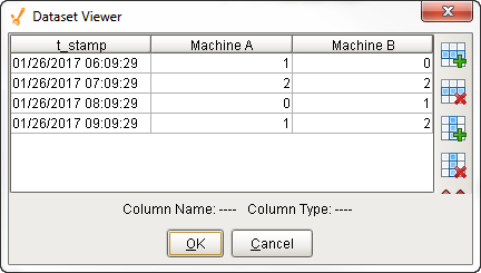

The Dataset Viewer window showing the dataset behind the Symbols Axis chart: a t_stamp column with four hourly timestamps from 01/26/2017 06:09:29 to 09:09:29, and Machine A and Machine B columns holding the state numbers 0, 1, and 2 that the symbol axis maps to On, Off, and Auto.

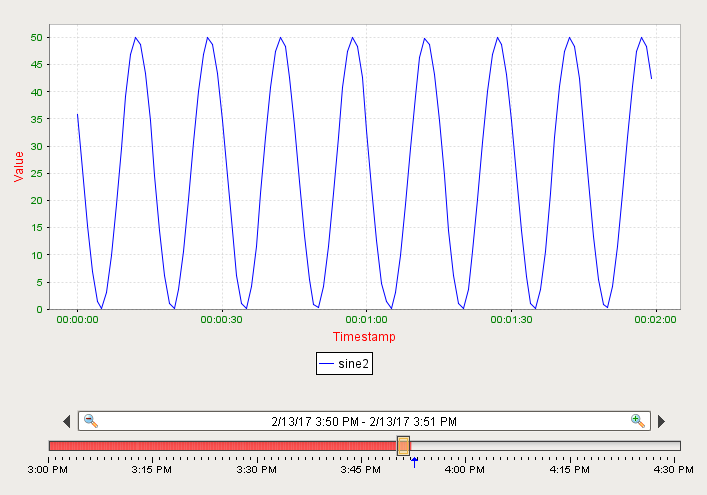

Elapsed Time Axis Chart​
A line chart with a Value Y axis from 0 to 50 and a red-labeled "Timestamp" X axis whose green tick labels show elapsed time rather than clock time, running from 00:00:00 to 00:02:00 in thirty-second steps. A single sine2 series oscillates through several full cycles, with a legend below the plot. Beneath the chart are a date range selector reading "2/13/17 3:50 PM - 2/13/17 3:51 PM" and a time-range slider spanning 3:00 PM to 4:30 PM.
Binding Type​
  • Database
  • SQL Query
Datasets Tab
Property NameValue
DatasetData
X-Axes Tab
Property NameValue
AxesElapsed Time
Axis LabelTimestamp
Axis Label ColorRed
Upper Bound60,000
Tick Size (ms)30,000
Y-Axes Tab
Property NameValue
AxesDefault Y Axis
Axis LabelValue
Axis Label ColorRed
Property NameValue
DatasetsData
X AxisElapsed
TypeLines Only

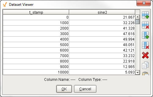

The Dataset Viewer window showing the dataset behind the Elapsed Time Axis chart: a t_stamp column of elapsed milliseconds counting up from 0 in steps of 1000, and a sine2 column of the corresponding values.
