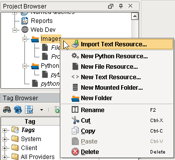

Basic Usage​
Each type of resource may specify its content type. It is important to specify the correct content type for the contents of the resource. When the Web Dev module is installed, a new kind of project resource heading will appear in the Designer's project browser called "Web Dev". Right-clicking on this heading will allow the creation of several new types of project resources:
Python Resource​
Python resources are dynamic web resources. Each time a user browses to the URL associated with a python resource, the script will run and generate a response in the form of a python dictionary. See Return Value for more details on formatting this response.
File Resource​
A file resource is a static resource, usually a binary resource such as an image. Note that you will need to re-import a file resource if it has been changed since adding it to Web Dev.
Text Resource​
A text resource is a static resource much like a file resource, except that its contents may be directly edited from within the Ignition Designer. These are useful for static HTML, CSS, and JavaScript files.
Mounted Folder​
Mounted Folders are a way to expose a folder from the gateway's hard drive as a resource endpoint. For example, if the Ignition server had some directories that look liked the following:
