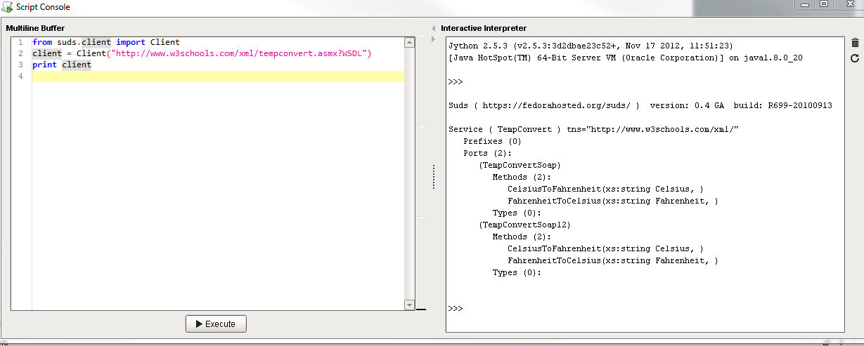

  1. First, we can use the script playground to test out some scripting calls and see the output. The below example shows how to get a reference to a client object. By printing this client object to the console we get an output of all the available methods, types, and other information about the web service as defined in the WSDL file.
    Python - W3Schools WSDL
    from suds.client import Client
    client = Client("http://www.w3schools.com/xml/tempconvert.asmx?WSDL")
    print client

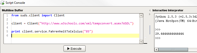

    This WSDL defines two functions: CelsiusToFahrenheit(string tempCelsius) and FahrenheitToCelsius(string tempFahrenheit). These are the functions that this web service makes available to you. Don't worry about the fact that the methods are listed twice. This is just because the WSDL has two definitions of the functions that are formatted for different SOAP version standards. To call these functions in Ignition scripting, you have to make use of the "service" member of the client object. You can see printing the returned results shows the conversion:

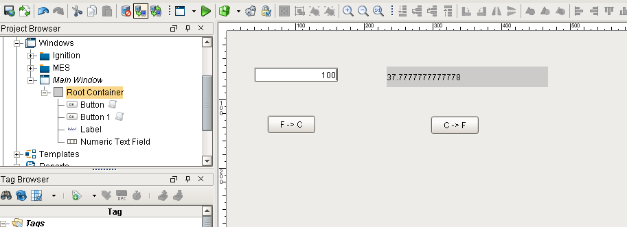

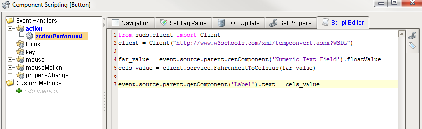

  2. To make a simple conversion window in an Ignition project you can add a button, a numeric textbox, and a label to a window. Then on the button to calculate a Fahrenheit to Celsius calculation, you would place something like the following:
    Python - Fahrenheit to Celsius
    far_value = event.source.parent.getComponent('Numeric Text Field').floatValue
    cels_value = client.service.FahrenheitToCelsius(far_value)
    event.source.parent.getComponent('Label').text = cels_value

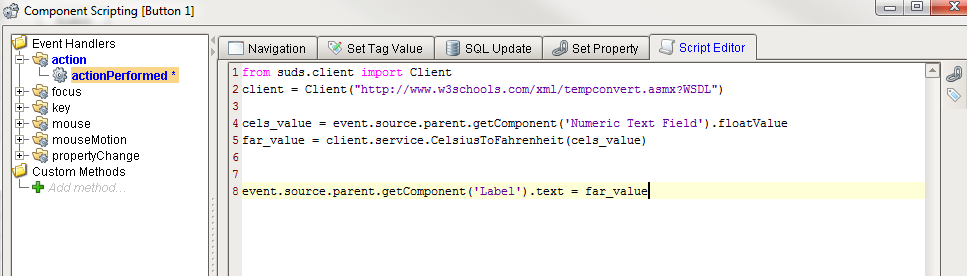

  3. Then you can make a second button to do the opposite: calculate Celsius to Fahrenheit.
    Python - Celsius to Fahrenheit
    cels_value = event.source.parent.getComponent('Numeric Text Field').floatValue
    far_value = client.service.CelsiusToFahrenheit(cels_value)
    event.source.parent.getComponent('Label').text = far_value
  4. With your scripts in place your window should now function as a simple temperature conversion tool!
