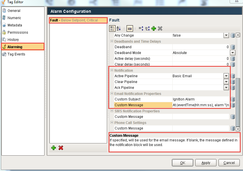

Customizing Email Message Scripts using Alarm Configuration in the Tag Editor​
  1. To customize an Email alarm notification, select your Tag, and go to the Alarm Configuration screen. Scroll down and you will see Notifications, Email Notification Properties, SMS Notification Properties, and Phone Call Settings.
  2. In the Notification section, you can specify the name of the alarm pipeline that you want to trigger when an alarm becomes Active, Cleared and Acknowledged. Simply enter the name of the alarm pipeline next to the relevant state you want the email sent out from. This example uses the ‘Basic Email’ pipeline, and the alarm is triggered on the 'Active' state.
  3. Enter a Custom Subject called 'Ignition Alarm'.
  4. Create your Custom Message. You can use static text, bring in Tag values and special alarm properties. You can even bind a particular property to an expression to concatenate a string that is using other values that are in the system. This example displays the alarm name, state, and time in hours, minutes, and seconds.
    Custom Message Script
    The "{name}" alarm became {eventState} at {eventTime|hh:mm:ss} with a value of "{Value}"
    Notice that when you select any fields in the Alarm Configuration, the Description Area at the bottom of the window displays details about the property's behavior.
  5. When complete, press OK.

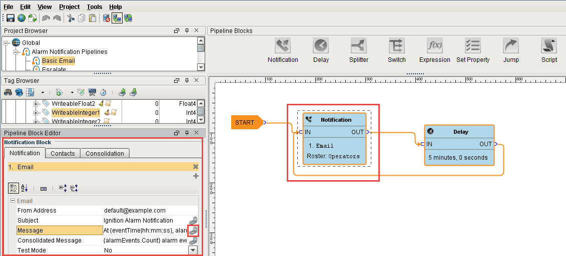

Customizing Email Message Scripts using the Pipeline Notification Block​

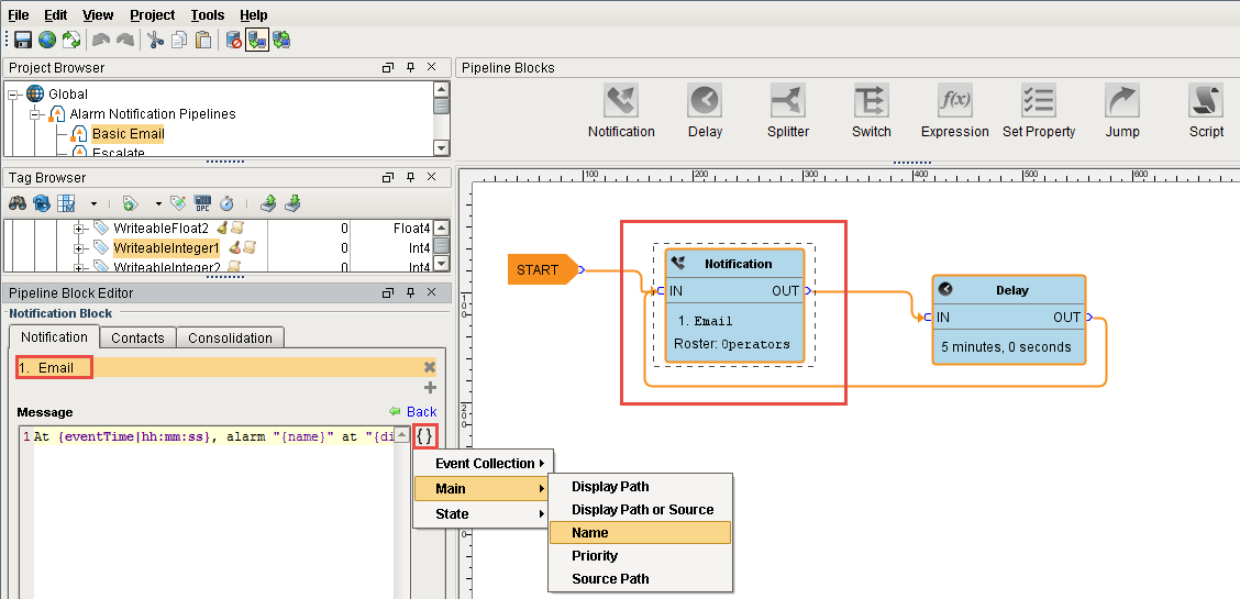

  1. Click on the Notification Block of your pipeline, and choose Email. You can see all the default Email settings for each field in the Notification Block. Click on the Link icon next to the Message field to expand the script.
    Customize Email Message Script with Notification Block Step 1
  2. Here, you can customize the default message script using the built-in alarm properties. Click on the Curly Braces icon to see a list of properties to help you build your custom message script.
    Customize Email Message Script with Notification Block Step 2

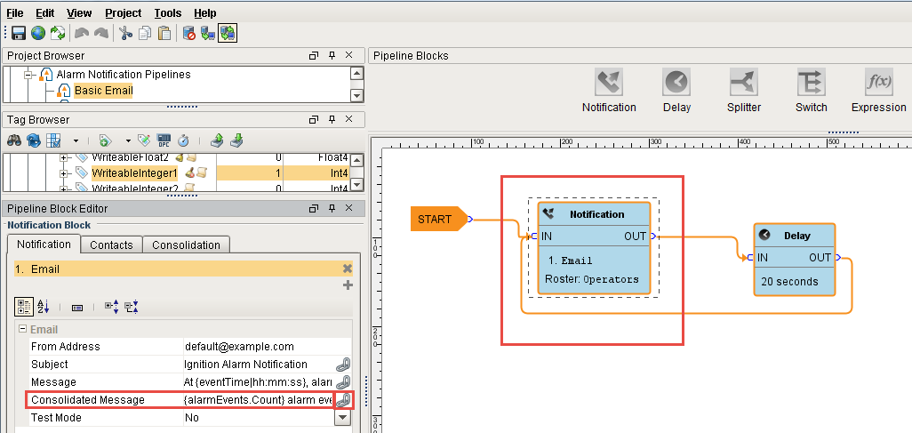

  3. If you want to use Consolidation, you can use the default Consolidated Message script or create a custom script using the alarm properties. Click on the Link icon to expand the Consolidated Message script.
    Customize Email Message Script with Notification Block Step 3

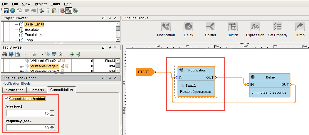

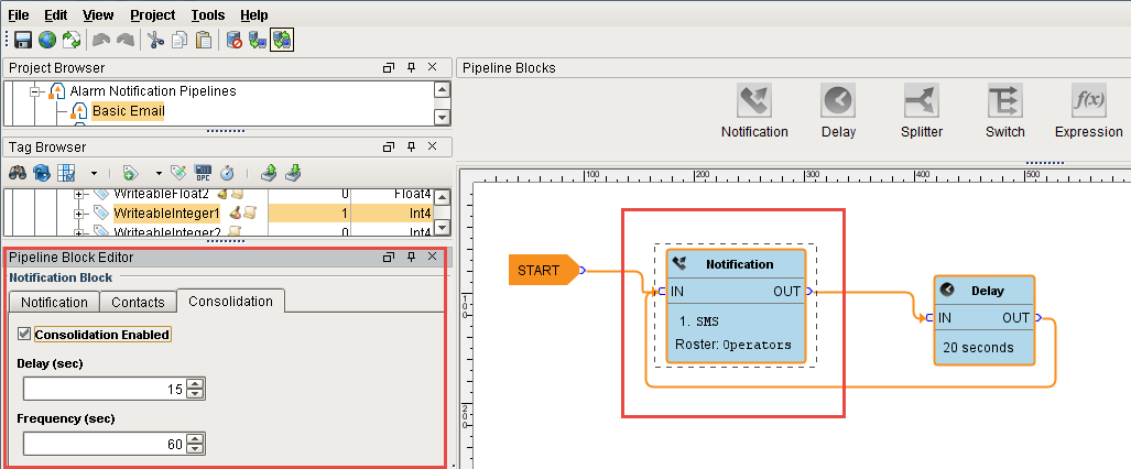

  4. If required, go to the Consolidation tab, and enable Consolidation. When enabled, multiple alarm events are sent together in one email, which results in fewer messages being sent out. For more information on the Delay and Frequency settings, refer to Consolidation.
    Customize Email Message Script with Notification Block Step 4

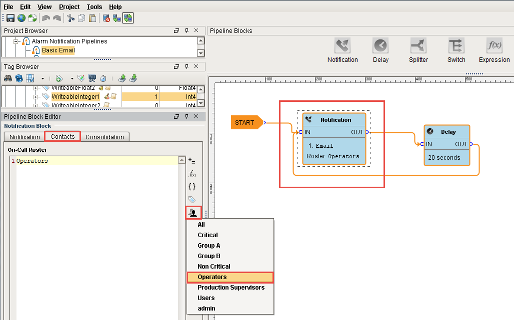

  5. Next, from the Contacts tab, choose the On-Call Roster that you want to send email notifications too.
    Customize Email Message Script with Notification Block Step 5

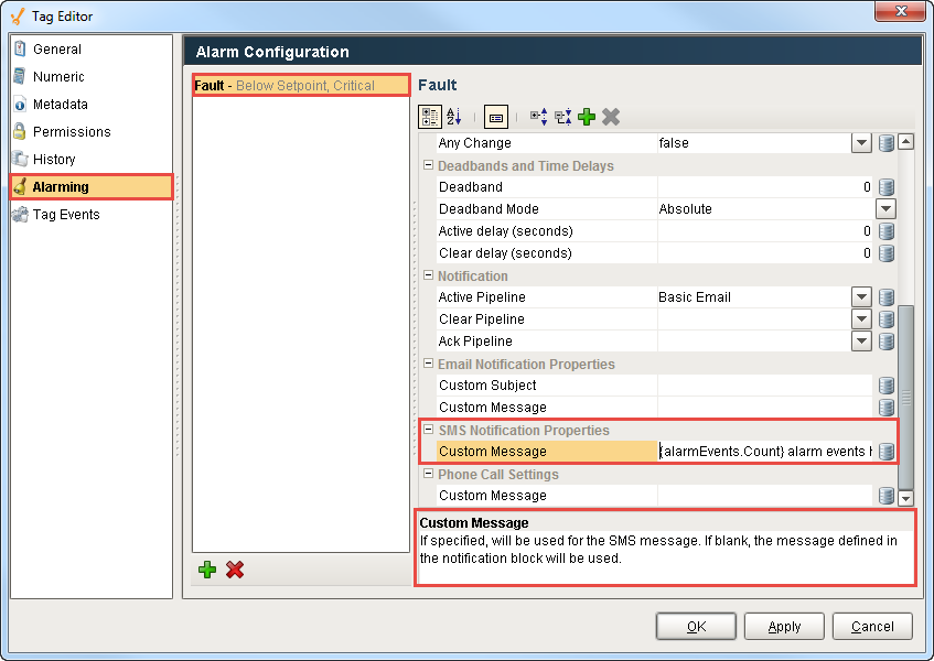

  1. To customize an SMS alarm notification, select your Tag, and go to the Alarm Configuration. Scroll down to SMS Notification Properties.
  2. In the Notification section, specify the name of the alarm pipeline that you want to use when the alarm becomes Active, Cleared and Acknowledged. In this example, the name of the pipeline is ‘Basic Email’ and is triggered on the 'Active' state.
  3. Enter your Custom Message script or use the default script. You will notice there is no Subject, only a Custom Message.
  4. When you're finished customizing the alarm configuration, click OK.
  5. Go to the Pipeline Notification Block and from the Contacts tab, choose the On-Call Roster that you want to send alarm notifications too.
  6. If required, go to the Consolidation tab, and enable Consolidation. You can use the default Consolidated Message script or customize the script. Set the Delay and Frequency settings.

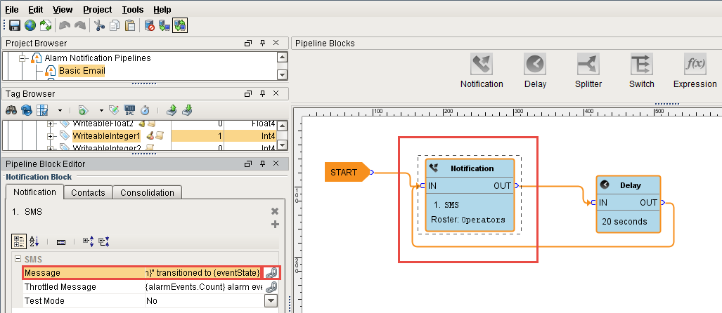

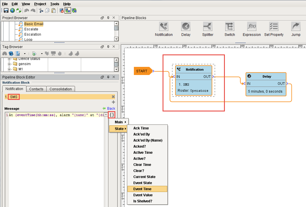

Customizing SMS Message Scripts in the Pipeline Notification Block​
Another way to customize the default SMS alarm notification is to build your custom message in the Pipeline Notification Block.
  1. Click on the Notification Block of your pipeline, and choose SMS. You can see all the default SMS settings in the Notification Block. Click on the Message link icon to expand the script.
    Customize SMS Message Script with Notification Block Step 1
  2. You can either use the default message script or customize one using the alarm properties. Click on the Curly Braces to see a list of available properties.
    Customize SMS Message Script with Notification Block Step 2

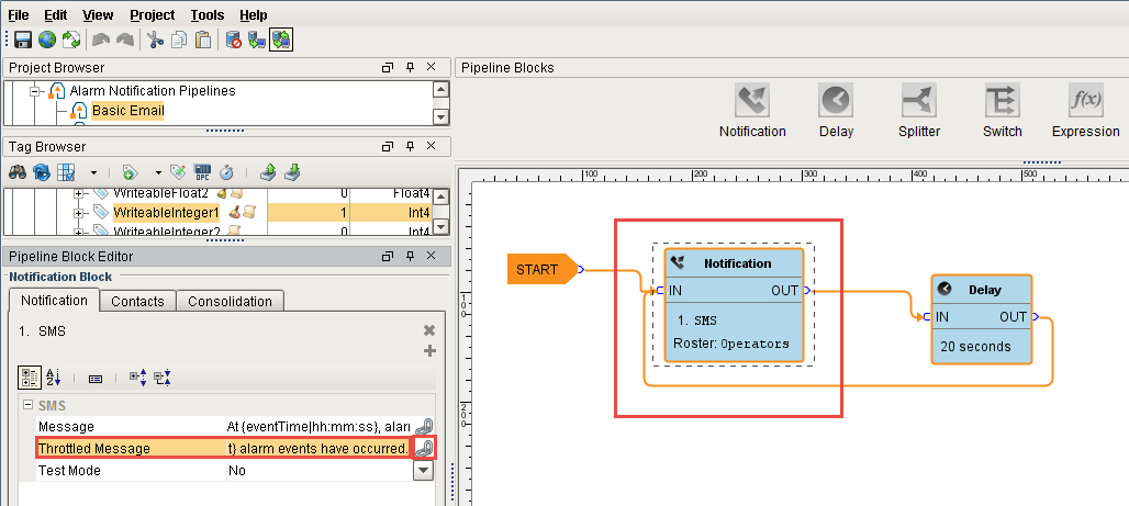

  3. Like Email, use the Consolidated Message when multiple alarm events are sent together. In SMS, click on the Throttled Message link icon to expand the consolidated script. You can either use the default script or create your own custom message using the alarm properties.
    Customize SMS Message Script with Notification Block Step 3

  5. If required, go to the Consolidation tab, and enable Consolidation. Enter your Delay and Frequency settings.
    Customize SMS Message Script with Notification Block Step 5

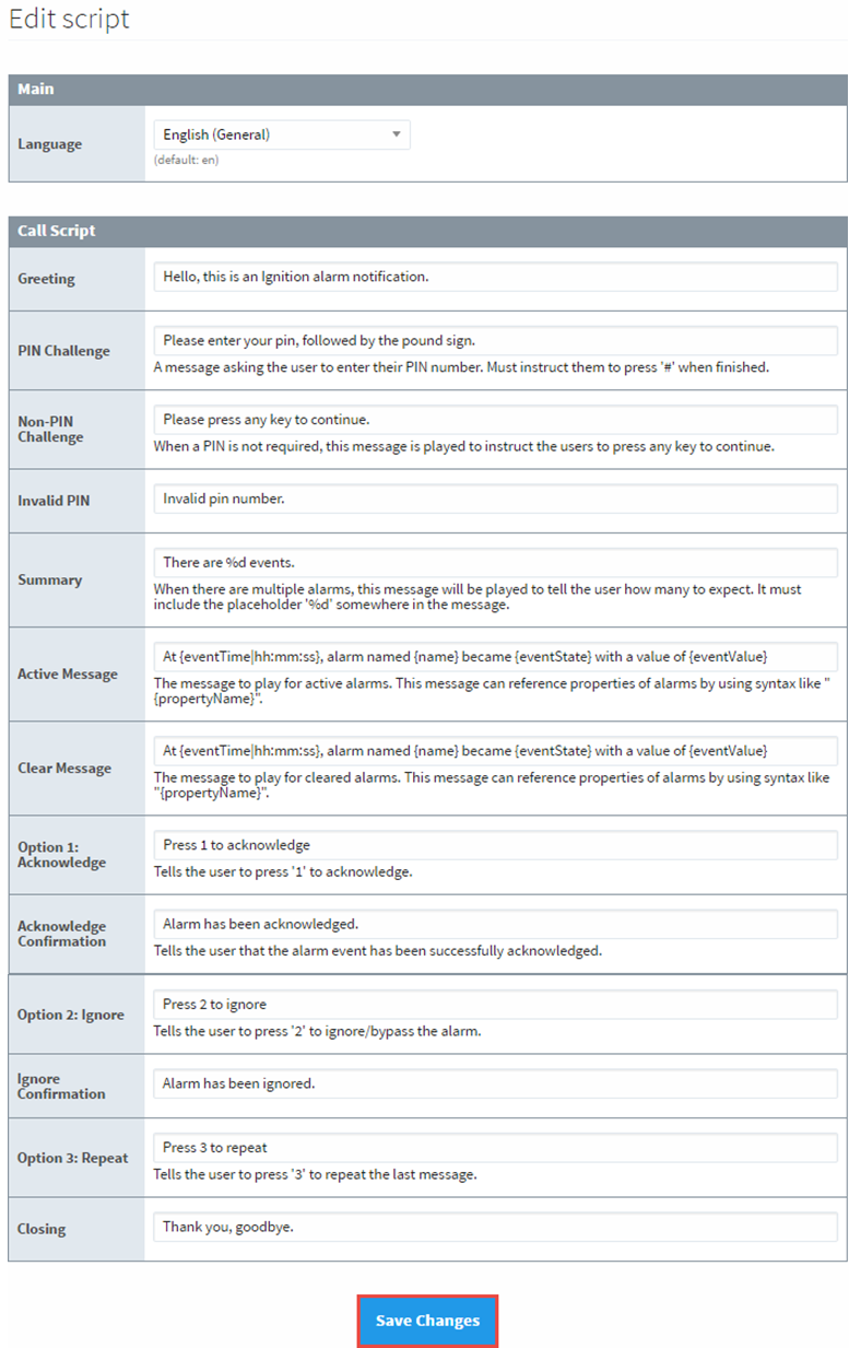

Voice Call Script​

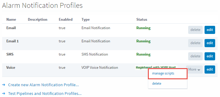

The voice message played to the the user during the phone call is defined in the call script which is located in the Voice Notification Profile. The voice message is built off a message template that can reference properties in the alarm. Be aware that the voice message is shared across all voice notification profiles. If you define a custom message, it will be used instead of the default message in the call script.  Use the following steps to access the default call message template and create your own voice call script.
  1. Go to the Configure page and select Alarming > Notification.
  2. This opens the Alarm Notification Profiles. Next to the Voice Notification Profile, click More and select Manage Scripts from the dropdown.
    Voice Call Script Step 2

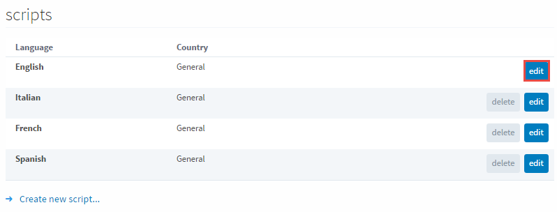

  3. Select your preferred language script and click Edit.
    Voice Call Script Step 3
  4. Edit the voice message script and click Save Changes.
    New in 7.9.12
    You can stop any of these Call Scripts from being read by removing all text in that field.
    Voice Call Script Step 4

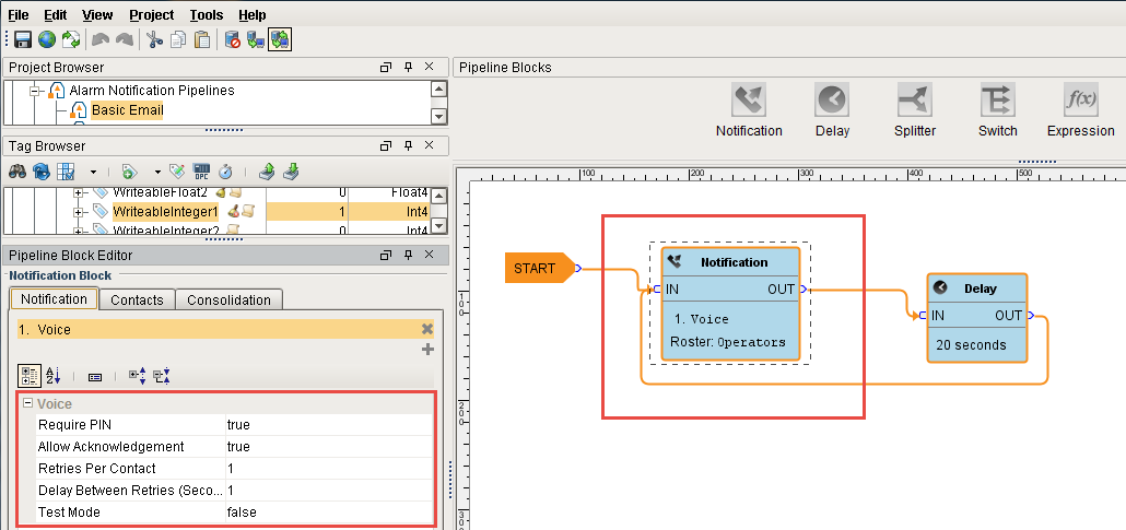

The Voice Notification system is primarily accessed through the Notification Block. The only settings you can configure in the Alarm Configuration section is the Custom Message, and the Alarm Pipeline which defines what state you want to trigger the alarm. All Voice settings that you need to configure are in the Notification Block.
  1. Click on the Notification Block of your pipeline, and choose Voice.
  2. Configure each setting for your Voice alarm notification, as required.
    • PIN Required - If required, the user will need a PIN to hear the alarm notification. PINs are defined in the user's profile.
    • Allow Acknowledgement - If Acknowledgement is not required, users will only be allowed to listen to an alarm and not acknowledge them.
    • Retries per Contact - Number attempts to contact user by phone.
    • Delay between Calls - Creates a delay between each contact for each alarm. For most phone systems, a delay of 1 second is recommended.
    • Test Mode - If enabled, messages will be logged to the console indicating when and to whom calls would have been made without actually making a call.
  3. This example shows how you might configure your Voice settings, but it depends primarily on your business requirements.

    Configuring the Voice Call Script
