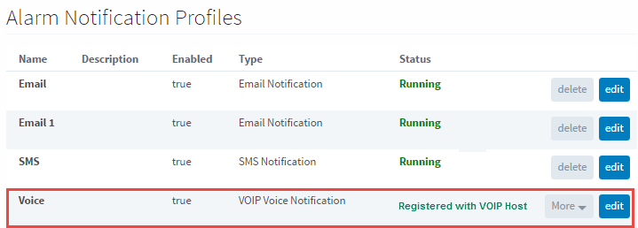

After saving the profile, you should see the status update from “Unknown” to “Registered”, indicating that the Gateway has successfully registered with the SIP Gateway. If you see an error, verify that the settings are correct, and that the username and password are correct. The system log console can also be useful in determining what is wrong.

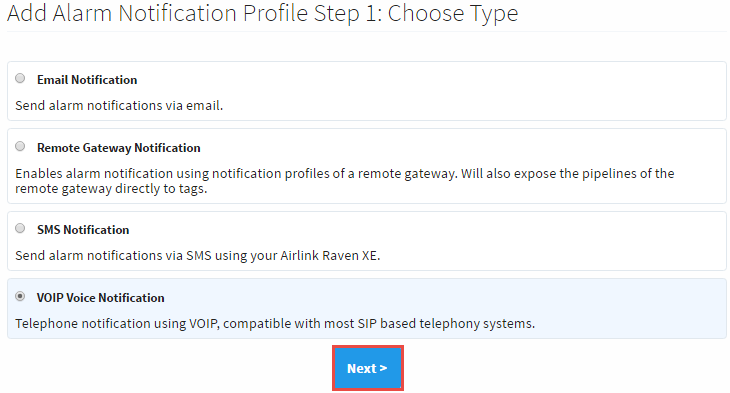

  3. Click on the Create new Alarm Notification Profile link.
    Create a new Notification Profile
  4. The Add Alarm Notification Profile Step 1 window will appear. Select the VOIP Voice Notification radio button a click Next.

  5. On the New Alarm Notification Profile page, configure your settings. Enter the Gateway Address or domain name of your SIP Gateway. You may be required to enter a username and password. There are also some additional call settings that may need to be setup depending on how you want to manage your calls, and based on your preference. When completed, click Create the New Alarm Notification Profile. Your new Voice Notification Profile will be displayed with a status of Registered with VOIP Host.
