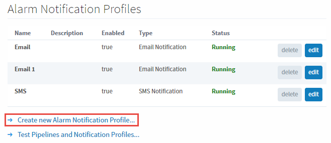

  3. A list of Alarm Notification Profiles will appear. Click on the Create new Alarm notification Profile link at the bottom of the page.

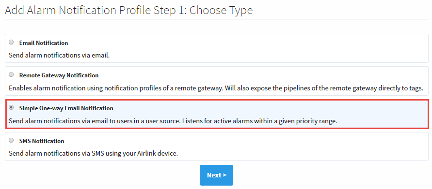

  4. A list of all the alarm notification profile types will appear. Choose Simple One-way Email Notification, and click Next.

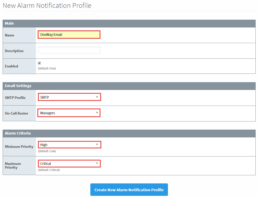

  1. Configure the profile settings for the Simpl One-way email Notification Profile, and then click Create New Alarm Notification Profile.
    • Name: OneWay Email
    • SMTP: SMTP (Please see the Email Settings page for more information on creating an SMTP profile.)
    • On-call Roster: Manager (For more information, please see the On-Call Rosters page.)
    • Minimum Priority: High
    • Maximum Priority: Critical
This notification profile example below is configured to send email notifications to the users in the Managers On-Call Roster when the alarm criteria is High or Critical.

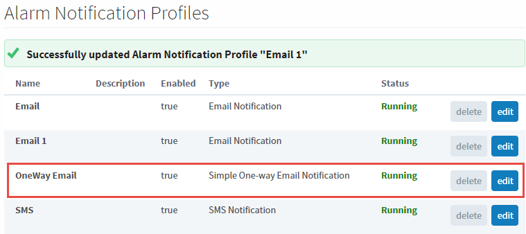

  1. Once created, the Simple One-way Email Notification Profile will appear in your Alarm Notification Profiles list, and it will be running. You can edit the profile to change the On-Call Roster and/or alarm criteria at any time. You can create as many Simple One-way Email Notification Profiles as you need.
