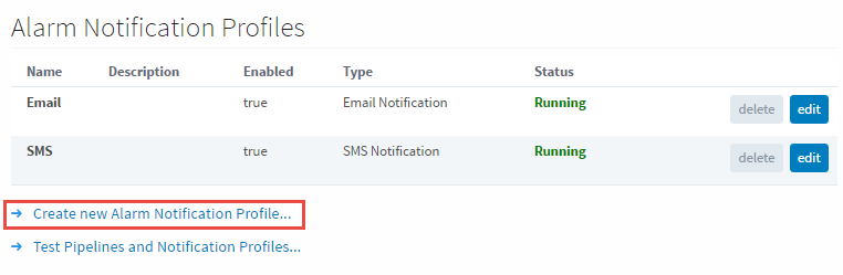

  1. Go to the Configure section of the Gateway webpage.
  2. Select Alarming > Notification from the menu on the left side. The Alarm Notification Profiles page will be displayed.
Alarm Notification Gateway Config List
  1. Click on the Create new Alarm Notification Profile link.

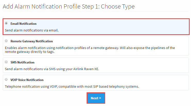

Alarm Notification Create New Pipeline
  1. A list of available alarm notification profiles appear. If any of the profiles are not displayed, it means the required module is missing, or faulted. (To verify that the Alarm Notification Module is installed and running, click on Modules from the menu bar on the left side). Choose Email Notification, and click Next.

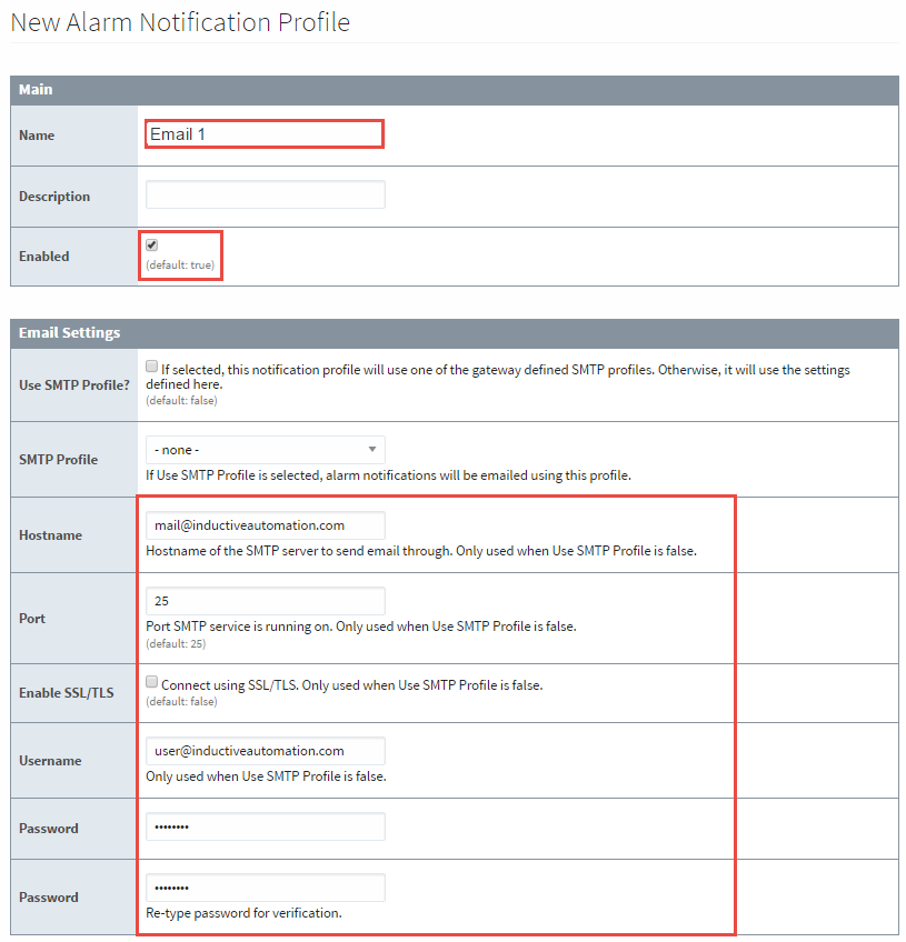

  1. Configure the settings for the Email Notification Profile, and then click Create New Alarm Notification Profile.
    • Enter a Name: Email 1
    • Click the Enabled box to enable Email notifications.
    • Enter the Hostname. This is the hostname of the SMTP server that will be responsible for sending the emails.
    • Enter the Port. The default is Port 25, but your mail server may be different.
    • Enable SSL/TLS if you are using encryption.
    • Enter your Username and Password if they are required.

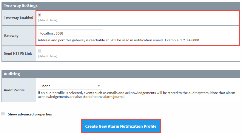

    • Click the Two-way Enable box if you want to make your Email Notification Profile two-way so that the operator can acknowledge the email. There is a link to acknowledge the alarm in the email.
    note
    You must have a connection back to the Ignition Gateway. So, if you are working from home and not on a VPN, you will either have to get on a VPN or expose your Ignition server on the internet. You can do this with port forwarding, talk to your IT department about it.
    • Auditing: You have the option of attaching emails to an Audit profile so that Ignition can store all the events associated with the Email Notification Profile. (I.e., who is receiving alarm and who is acknowledging an alarm).

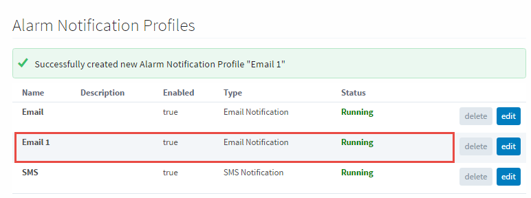

  1. Once you create your Email Notification Profile, it will appear in the Alarm Notification Profiles list, and it will be running. You can edit the profile at any time to change any of the settings, and create as many Email Notification Profiles as you need.
