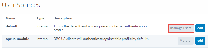

  1. Go to the Gateway Configure page, Security > Users, Roles, and under default user sources, select the manage users link.
    User Profile Step 1

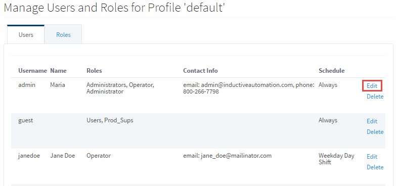

  2. Here you will see list of all your users. For every user that is using Voice and/or SMS alarm notifications, you will need to edit their user profile to create a PIN. Select the Edit link for one of your users.
    User Profile Step 2

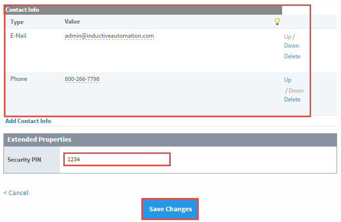

  3. The user profile screen will open. Scroll down to the bottom of the screen, and make sure the contact information for Email and Phone is up-to-date.
    Create a 4-digit Security Pin, and press Save Changes.
    Now, this PIN is associated with this user.
    User Profile Step 3

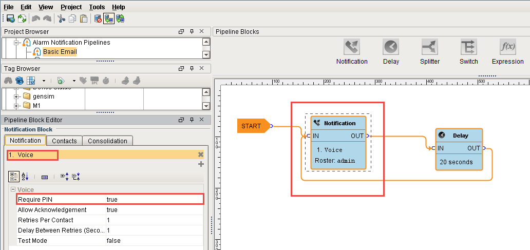

Voice Notification Profile​
The next step is to configure the Voice Notification Profile to require a PIN.
  1. In Designer, go to your Alarm Notification Pipelines and open your pipeline. This example uses the Basic Email pipeline. Select the Notification Block in the workspace.
  2. Click on the Notification tab, and choose Voice.
  3. You’ll see several settings for Voice. Set the Required PIN to 'true'.
Now, when the operator receives a call, they will have to type in their PIN number followed by the pound sign to hear the message.
