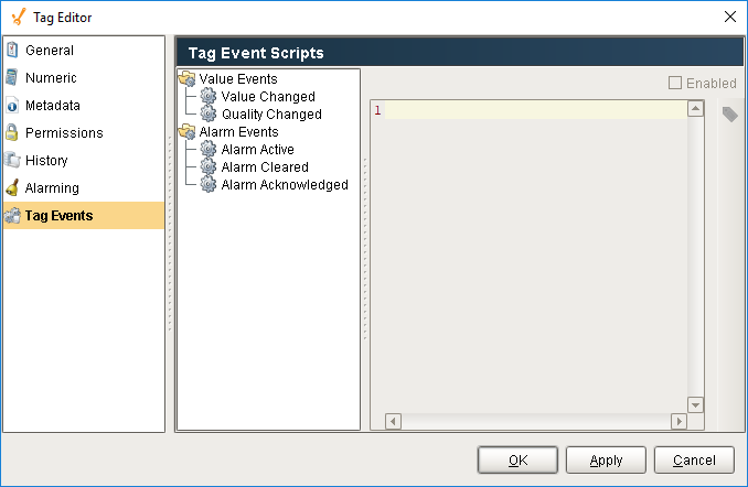

Tag Event Overview​
Scripts can be attached to Tags. When you edit a Tag, you can navigate to the Tag Events section to see a list of all of the available events. Those events are
  • Value Changed
  • Quality Changed
  • Alarm Active
  • Alarm Cleared
  • Alarm Acknowledged
Each event is unique and can have specialized arguments depending on the event. Also, because Tags are stored in the Gateway, all these scripts fire in the Gateway scope.

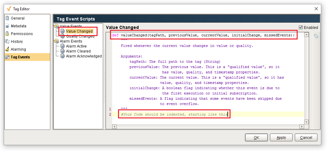

Event Scripts are Functions​
Once an event has been selected, note that the top of the text area is defining a function. As a result, all code that should execute when this event occurs should be indented at least once to be included in the definition.

Value Changed​
The Value Changed event is fired whenever the value of this particular Tag changes. This event has a variety of arguments available for use in the script:
  • String tagPath - The full path to the Tag. Object previousValue - The previous value. This is a qualified value, so it has value, quality, and timestamp properties.
  • Object currentValue - The current value. This is a qualified value, so it has value, quality, and timestamp properties.
  • Boolean initialChange - A boolean flag indicating whether this event is due to the initial subscription or the first execution after a Tag update.
  • Boolean missedEvents - A flag indicating that some events have been skipped due to an event overflow.
info
The currentValue and previousValue arguments are qualified values. This means that to get to the actual current value, it would look like currentValue.value.
