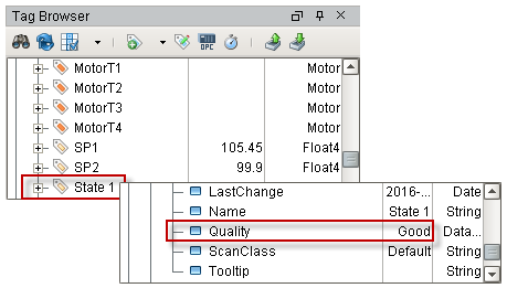

  • In the Tag Browser, find your Tag, expand it, and scroll down to the meta property called Quality. Here, you can see if the quality of the Tag is either Good or Bad Quality. This example shows a Good Quality Tag, meaning the Tag can be trusted.

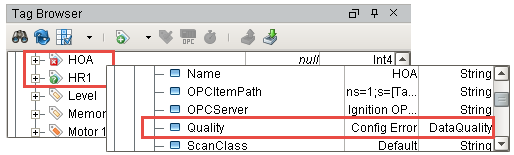

  • One obvious indicator if the Tag is of bad quality is if there is an overlay on the Tag itself. This example shows two Tags with overlays that have a quality issue. The HOA Tag was expanded to show that there is a Configuration Error and the HR1 Tag has an Unknown issue. Ignition typically tries to identify the Quality issue to help you resolve it promptly.

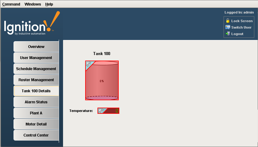

  • Quality is also reflected on the component in the window of the Designer and Runtime using an overlay. Using an overlay on a component lets the operator know that they could be looking at a bad value for that Tag. When the overlay goes away and the values start coming in again, the operator knows that it's a valid Tag, and the values can be trusted. Bad Quality overlays on components look like the ones in this example which show a Tag's Evaluation Error.

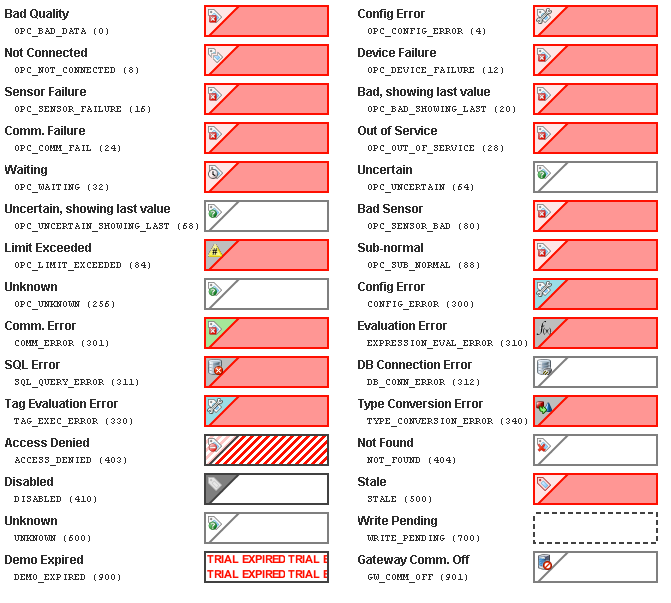

It is especially important in HMIs to be able to gauge the health and accuracy of what is displayed at a glance. In a highly distributed system like Ignition, it is especially important, as the client may be located at quite a distance (maybe across the world) from the physical process it is monitoring and controlling.
For these reasons, components display visual overlays (as shown below) for various reasons to indicate that the data they are displaying is not good, or pending a reply from the device. Each data binding that drives a component is evaluated for quality. If any of these qualities becomes poor, the component will show an overlay. The different overlays can mean different things, denoting their underlying cause. What they indicate is based on the Quality properties of Tags. The table below shows all the available overlays Ignition provides.

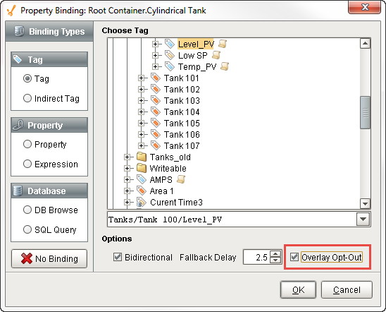

Overlay Opt-out​
Choosing the Overlay Opt-out option will ignore the quality of the chosen Tag, making it have no effect on the component's quality overlay. The Overlay Op-out option is located in the Tag bindings for components. If this option is enabled, the operator will not see any overlays and will have no indication that the underlying Tag quality is something other than good. A word of caution when you use the Opt-out option because you always want to give the operator some indication that the values they are seeing on the screen can be trusted, and by opting out, you are removing that indicator for the operator.
