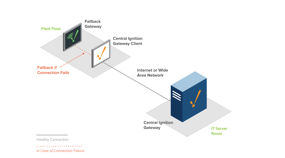

This User Source was developed specifically for a system that is using Local Client Fallback, and allows you to cache the login credentials from a remote user source. This means your users can still log in with their normal username/password on a Local Client Fallback project, even when the network connection is unavailable.

Users and Roles can not be manually added to the Fallback Cache. Instead, they are automatically copied from remote Gateways. This type of User Source is normally configured on an Edge Gateway, but can be utilized on an Ignition Gateway.
  1. Before the Fallback Cache will populate, both the Central Ignition Gateway and Fallback Gateway must be connected over the Gateway Network. The credentials are passed from a User Source on the Central Ignition Gateway to the Fallback Cache over the Gateway Network.
  2. A Fallback Cache User Source must exist on the Fallback Gateway.
  3. A client must be launched on the Fallback Gateway from the Central Ignition Gateway. If the user successfully authenticates against the Central Ignition Gateway's User Source, then the credentials are cached into the Fallback Cache.
