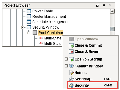

  1. Right-click on a component and select Security. The Security Settings panel is displayed in the bottom section of the Property Editor.

You can configure security settings that control who can and who can't open a window. While in the Designer, right-click on a window in the Project Browser and select Security. Window Security is configured the same way that Component Security is configured.
