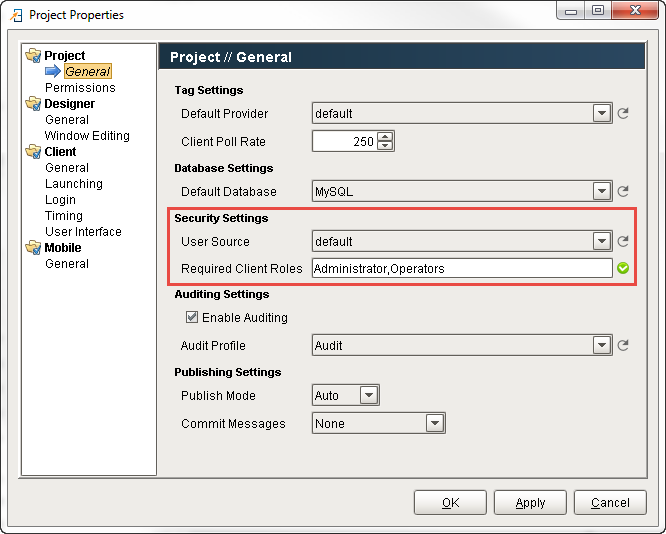

To Add a Required Role to a Client​
  1. From the Designer, go to Project > Properties and go to the General section.
  2. In the Project Properties window, under Security Settings, select the User Source from the drop-down menu.
  3. Enter the Required Client Roles that the Client needs in order to access the Client. This field will show all matching roles as you start typing. Multiple roles may be specified by separating them with a comma.
  4. Click OK to commit the settings.
  5. Save your project.
