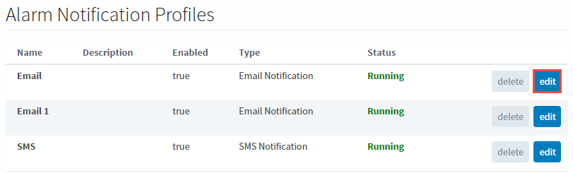

  2. Choose Alarming > Notification from the menu on the left. The Alarm Notification Profiles page is displayed.
  3. Edit the appropriate notification profile by clicking the edit link.

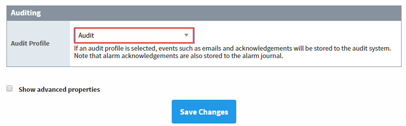

  1. The Edit Alarm Notification Profile page is displayed. Scroll down to the Auditing section, and select an Audit Profile from the drop-down menu. Click Save Changes, and Ignition will automatically begin storing information.
Now that the alarm notification profile is storing data into the Audit system, you have a complete log of all alarm emails and acknowledgements that you can review.
