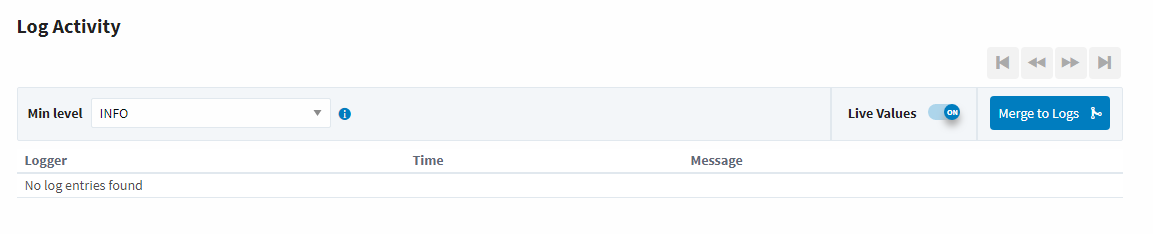

Log Activity​
Most of the systems in the Connection section have a Log Activity area somewhere within the details of the connection. This Log Activity area functions much like the Logs in the Diagnostics section of the Status page in that you see a list of all log messages depending on the logging level you are looking at as well as the filters you have setup. However, what makes the Log Activity areas in each Connections page unique is that they are filtered to only show loggers for that particular system. This helps you narrow down any potential problems by showing you only the information that pertains to what you are looking at.
Connections page showing log activity
