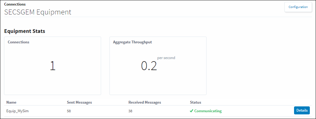

SECSGEM Equipment​
The SECSGEM Equipment page displays a list of all equipment connections, their status, as well as the number of sent requests and received messages. If any piece of equipment becomes faulted, it will show a status of "Not Connected." If you click the Details button, it opens a new page with some Connection Stats. Note: the SECSGEM Module is not standard and will be missing for most installs of Ignition. The SECSGEM Equipment Connection will only be displayed in the Status section of the Gateway webpage is when the module is installed.
Connections List with SECSGEM
SECS/GEM Equipment Page​
The main SECS/GEM Equipment page lists out all equipment connections and displays the number of messages sent between them and Ignition.
AttributeDescription
ConnectionsThe total number of active SECS/GEM Equipment connections.
Aggregate ThroughputThe messages per second the system is sending and receiving from all devices at that time.
NameThe name of the equipment connection in the list.
Sent MessagesThe number of messages sent to the equipment.
Received MessagesThe number of messages received from the equipment.
StatusThe status of the equipment.
Connections SECSGEM Equipment Page

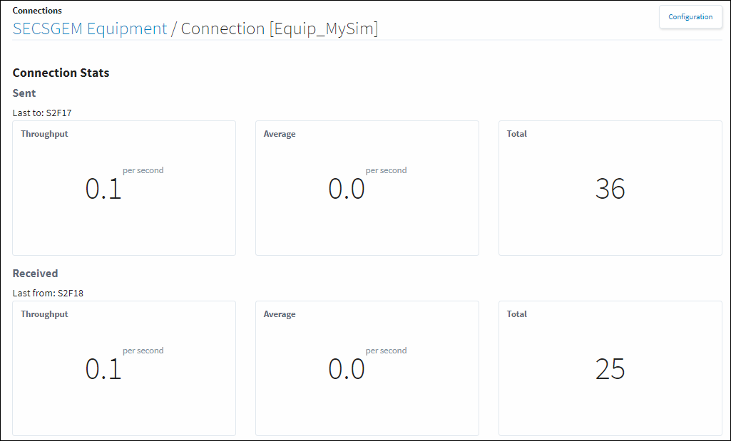

SECS/GEM Equipment Details​
Clicking the Details button to the right of a piece of equipment will take you to a page that shows more detailed information for that particular piece of equipment.
Sent Messages​
ThroughputThe messages per second the system is currently sending.
AverageThe average messages sent per second from when the equipment was first enabled.
TotalThe total messages sent.
Received Messages​
ThroughputThe messages per second the system is currently receiving.
AverageThe average messages received per second from when the equipment was first enabled.
TotalThe total messages received.
