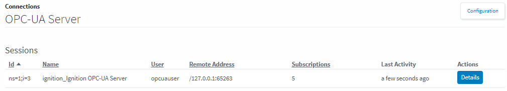

OPC-UA Server Page​
The main OPC-UA Server page contains basic information for all OPC-UA servers the Ignition system has access to.
AttributesDescription
IdThe id of the OPC-UA Server.
NameThe name of the OPC-UA Server.
UserThe user that is used to authenticate the connection to the server.
Remote AddressThe remote address of the server (127.0.0.1 is a local connection).
SubscriptionsThe total number of subscriptions or scan classes for this server.
Last ActivityThe last time the server had activity.
Connections OPCUA Page

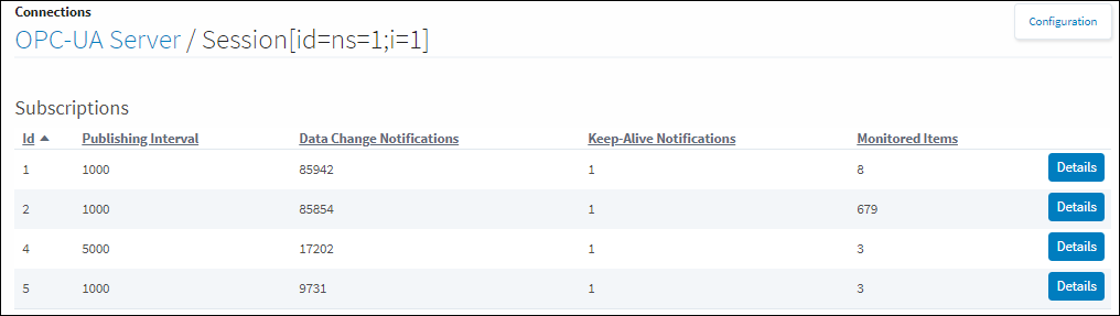

OPC-UA Server Details​
Clicking on the Details button to the right of an OPC-UA server brings up more detailed information for that particular server. It will list out all of the subscriptions to that server with the publish rate, as well as the number of items within that subscription.
| Attributes | Description | | Id | The Id of the scan class. | | Publishing Interval | The rate at which the subscription publishes. | | Data Change Notifications | The number of data changes that have happened for that subscription. | | Keep Alive Notifications | The number of keep alive notifications that subscription has done. | | Monitored Items | The number of items that are within that subscription. |
Connections OPCUA Details
