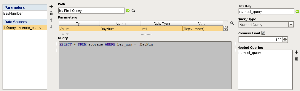

First select a Named Query by clicking the button next to the Path field.
In the resulting list, select one of the configured named queries. The Named Query parameters will appear, along with a preview of the query.
One-by-one, select each parameter, and then click the button next to the Parameters table. This provides a popup of all report parameters that are available on the report. Select a Report parameter that will provide a value to the Named Query parameter. Once every parameter has a value, check the results in the Preview Panel.
