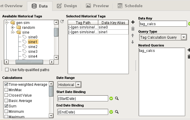

Tag Calculations are executed by the Tag Historian, providing multiple calculated values for each Tag path. While the Tag Historian Query returns a history of values and only uses the aggregates to perform calculations on small chunks of data in the range of time, the Tag Calculation Query will aggregate, or run calculations, on the entire range to produce a single, calculated value per Tag Path.
Assuming the following configuration:
We could show the query results on a table and view the following in the Preview Panel:
