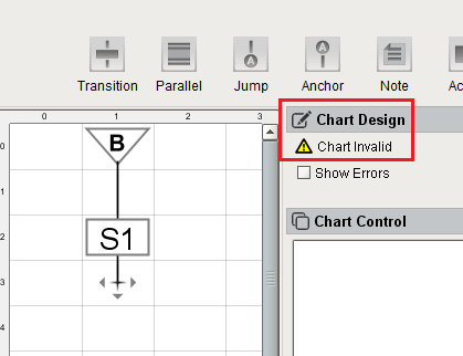

When developing a chart, there are several rules to keep in mind. Violating some of these rules will result in compilation errors on the Chart. The Designer's interface will report any chart errors in the Chart Design section.
When enabled, the Show Errors checkbox will highlight problem areas on the chart, as well as show the error when the mouse cursor is moved on top of the problematic area.
Flow must always lead into the top of an Element.​
While moving bottom-to-top is legal, flow may never enter the bottom of an element. If the flow leads to the bottom of an element, it is considered a dead-end, and the Chart will fail to execute.
The image below demonstrates an illegal Chart. This Chart will not execute because the flow from S2 is attempting to lead into the bottom of S3.
All Elements must be connected to the Chart​
Every element present should be linked to other elements in the chart. Rogue elements should be removed before the chart runs.
Links must connect to an element. Any link that is not connected is considered a dead-end, and must be removed.
This rule extends to links created inside of a Parallel element.
Flow may not lead into multiple Actions​
Outside of a Parallel element, only a single Action should run at any time. Flow that leads into multiple Actions will cause a compilation error because the chart does not know which Action to run. In cases where the Chart flows into multiple Actions, Transitions should be used to guide the flow. If multiple Actions must execute simultaneously, a Parallel element should be used.
Charts do not need an End Step​
Flow of the Chart must always lead somewhere, but an End Step does not have to be used. Charts can freely loop around indefinitely. If flow is blocked by a Transition, then the Chart is effectively awaiting input to execute.

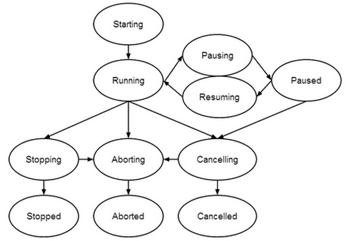

Each running chart is effectively a finite-state machine: the Chart can be in one of many different states, but it is only ever in a single state at any given moment. The current state of the Chart carries significant meaning.
The figure below shows each potential state a chart can be in, and outlines which states are accessible from each other state.
Active States​
The following states are common to the lifecycle of a running chart.
StateDescription
StartingThe Chart begins. The On Start Event Script triggers at this point.
RunningThe Chart flows through its structure. Running charts generally spend most of their time in this state.
Pausing
When the Chart is requested to pause, it moves into this transitional state. The Chart will attempt to finish execution on all active scripts, and will not start any additional scripts.
Once all scripts have successfully finished, the Chart will transition to the Paused state. Charts may be paused from either the Chart Control section of the Designer, or by calling system.sfc.pauseChart.
PausedThe Chart will sit here indefinitely until requested to resume, or is canceled. This is an idle state where the Chart does not take any actions unless requested to do so.
ResumingOnce requested, the Chart will start up and briefly enter this state. Resuming a chart can be done from the Chart Control section of the Designer, or by calling system.sfc.resumeChart.
Terminal and Intermediary States​
Charts have three different terminal states, or end states. Terminal states denote that the chart has ended due to some reason. There are also three intermediary states that lead to the terminal states. When a chart ends in some way, the Chart transitions to an intermediary state before moving to the associated terminal state. This allows the Chart a chance to do some closing work before ending. The intermediary states are as follows:
StateDescription
StoppingThe Chart has reached an End Step, and will stop soon. In most cases, this is the preferred terminal state as the Chart successfully reached its end. The On Stop Event Script will trigger at this state. Once finished, the Chart will transition to the Stopped state.
AbortingThe Chart has encountered some sort of error, and must end abnormally. The On Abort Event Script will trigger. Once On Abort ends, the Chart will transition to an Aborted state.
CancellingSomething requested the Chart to cancel, or end before reaching the End Step. The On Cancel Event Script will trigger, and the Chart will transition to a Cancelled state. Cancelling can occur from the Chart Control section of the Designer, or by calling system.sfc.cancelChart.
What are there three different terminal states? All three terminal states essentially mean the same thing for the Chart: the instance will no longer run. The differences is how the Chart ended. When troubleshooting, it is helpful to know why a Chart ended; did it finish successfully, was there an error that prematurely ended the Chart, or did something request that the Chart stop?
Understanding how the Chart ends can greatly aid in tracking down any problems. To that end, it is highly recommended to place scripts on the On Abort event. This will clearly log when a chart failed.
