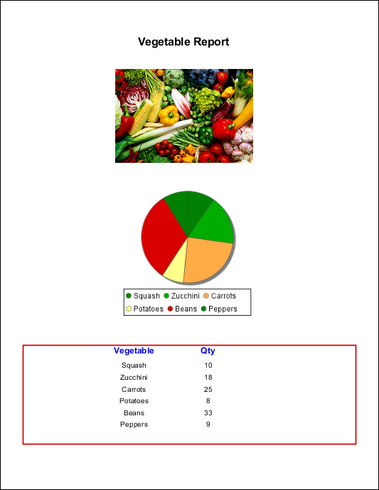

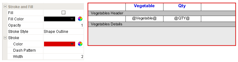

Stroke Style - Shape Outline Example​
This example shows a report with a Shape Outline around the Table component at the bottom of the image. Select the whole table to set stroke and fill for it. The property values used to create the outline around the data are shown in the properties list in the table below.
  • Stroke Style - Shape Outline
  • Stroke Color - Red
  • Width - 2 pixels

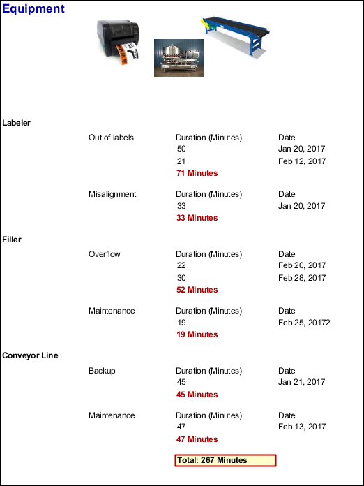

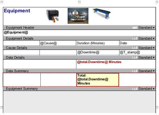

Stroke Style - Border Example​
This example used the Border Stroke Style for the Equipment Summary cell at the bottom of a Table. (Total: @total.Downtime@Minutes). Three images appear inside the outline because they are in the Equipment Header (unstructured) row. The property values are shown for the Table, Row, and Cell in the property lists below.
Equipment Table in the Designer​
Table Property Values​
  • Stroke Style - Border
  • Stroke
    • Border Bottom - Enabled
    • Border Left - Enabled
    • Border Right - Enabled
    • Border Top - Enabled
Data Summary Cell​
Shows the Total Downtime Minutes for each downtime cause for each piece of equipment.
  • Text Color - Red,Bold
Equipment Summary Cell​
Shows the Total Downtime Minutes for all causes and for all equipment.
  • Fill - Enabled
  • Fill Color - Yellow
  • Width - 2 pixels

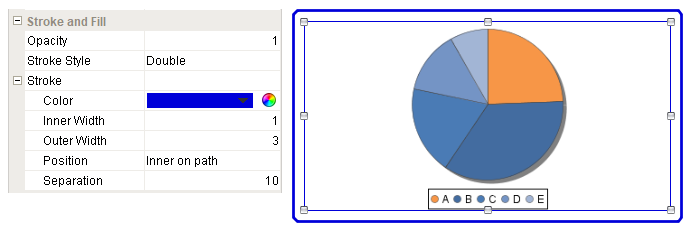

Double Style Stroke Properties​
By default, the Double Stroke Style consists of two parallel lines around the component. You can choose to disable any of the lines at the bottom, left, right, or top. You can also change the width of both lines and the separation between these lines, if desired.
PropertyDescription
ColorColor to use for the stroke.
Inner WidthWidth of the inner border in pixels.
Outer WidthWidth of the outer border in pixels.
PositionPosition of borders relative to the bounds of the shape.
  • Outer on path - Places the outer border on the edge of the component and the inner border inside the component.
  • Inner on path - Places the inner border on the edge of the component and the outer border outside the component.
  • Centered about path - Centers the whole border (based on inner+outer+gap widths) on the shape edge.
  • Gap on path - Centers on the gap on the shape edge.
SeparationSeparation between inner and outer borders in pixels.

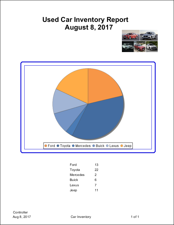

Stroke Style - Double Example​
Here is an example of a Pie Chart with a Double border used in a report. The property values for the Border Stroke Style are listed in the properties list table below.
  • Stroke Style - Double
  • Stroke Color - Blue
  • Inner Width - 1
  • Outer Width - 3
  • Position - Inner on Path
  • Separation - 10
