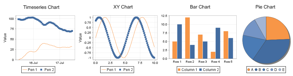

Report charts allow you to display your data in a graphical way, just like the charts in the rest of Ignition. Charts can be driven by any data source in a report, or even embedded into table rows using nested data sets. There are four types of charts so you can show the data any way you like.
  • Timeseries Chart: a simple chart that plots values against a timestamp X axis. Great for showing historical trending.
  • XY Chart: similar to the Timeseries chart, this chart plots lines on X-Y axes, but is configured to show numeric categores on the X axis.
  • Bar Chart: a bar chart that uses text categories on the X axis. Can be configured as a Pareto chart.
  • Pie Chart: a basic pie chart that uses text categories. Percentages are automatically calculated.

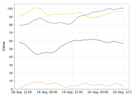

The Timeseries Chart is a type of XY chart whose domain or X-Axis represents time series data and range can be one or more pens. The Timeseries Chart is a great way to display data visually from Tag History, or similar time related data sources.
Usage​

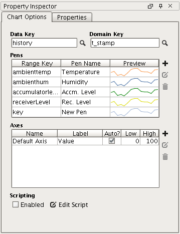

To use the chart, drag the component from the Report Palette to your report. Type or drag a data key from the Key Browser into the Data Key field of the Chart Options tab in the Property Inspector. Select a time series domain (for example a t_series column of your query). The Y axis (value) can be modified in the Chart Options tab, but the X axis (time range) is based on the data in the 'Data Key' that powers the chart dataset.

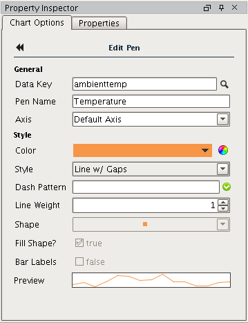

To add pens to your query, simply click the button on the Chart Options tab next to the Pens table in the Property Inspector. You can either double click a pen, or select a pen and click the button on the right side, to navigate to the Pen Configuration area. Click the to return to the Chart Options tab.
Chart Options area

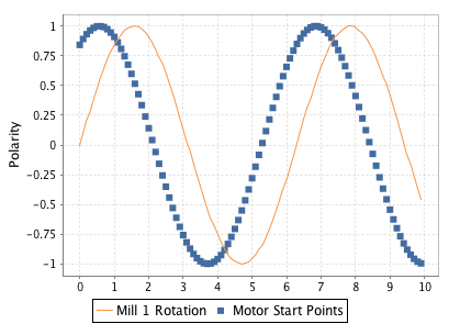

The XY Chart generates an X vs Y plot of your data. XY Charts can have multiple pens and axes per data source, and each is easily configurable in the Chart Options tab for the component.
Usage​
To use the chart, drag the component from the Report Palette to your report. Type or drag a data key from the Key Browser into the Data Key field of the Chart Options tab. Select Domain Key to use for the X axis.
To add pens to your query, simply click the button on the Chart Options tab next to the Pens table in the Property Inspector. You can either double click, or select a pen and click the button on the right, to navigate to the Pen Configuration area. Click the to return to the Chart Options tab. The setup and Configuration of this chart and its pens works similarly to the Timeseries Chart, the difference being that instead of using a date datatype for the domain, a different datatype is needed.

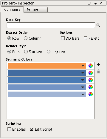

Bar Chart​

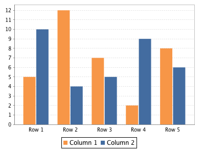

The Bar Chart component can be used to add bar charts to a report. It uses text categories on the X axis, and can also be configured as a Pareto chart.
Usage​
To create a Bar Chart, simply drag the component from the Report Palette and drop it onto your report. Bar Charts are quite easy to use and have a large number of customization options. Configuring a Bar Chart requires a data source whose first column generally contains the name or identifier the bar represents, and the following one or more columns represent some numerical value to be plotted. A Bar Chart example can be found in the Report Workflow Tutorial.

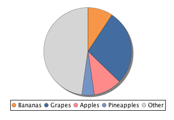

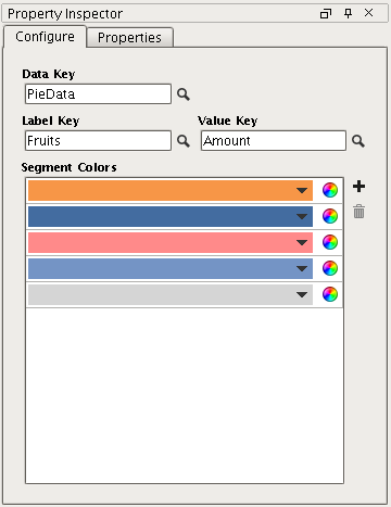

Pie Chart​
The Pie Chart adds a Pie Chart based on a simple two column data structure.
Usage​
To create a new Pie Chart, drag the pie chart palette item from the Report Design Palette onto your Report Page or Parent Shape. A pie chart has a simple configuration consisting of label values (generally Strings) and numeric quantity values. Color segments can be added or removed by clicking the button on the Configure tab.
The Pie Chart in the images above was created using a simple data source which had just two columns, the first which represented our Label, and the second being a column of values.
Fruits, Amount
"Bananas", 52
"Grapes", 154
"Apples", 58
"Pineapples", 25
"Other", 265
