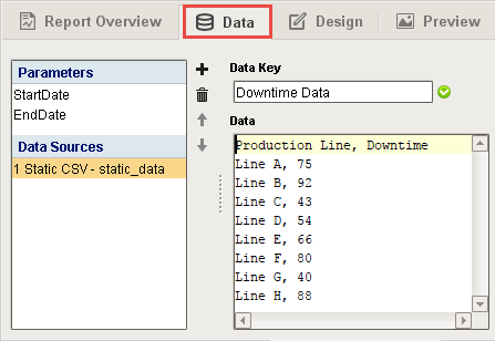

Adding a Datasource​
Datasource
This example uses a CSV file as it's datasource. You can use the one shown in the code block below, or create your own.
  1. In the Data panel, click the plus button to add a datasource, and select StaticCSV from the resulting list of options. From the code block below, copy the text and paste it into the Data field. This is the data that we will use in this example.
CSV Datasource
Production Line, Downtime
Line A, 75
Line B, 92
Line C, 43
Line D, 54
Line E, 66
Line F, 80
Line G, 40
Line H, 88

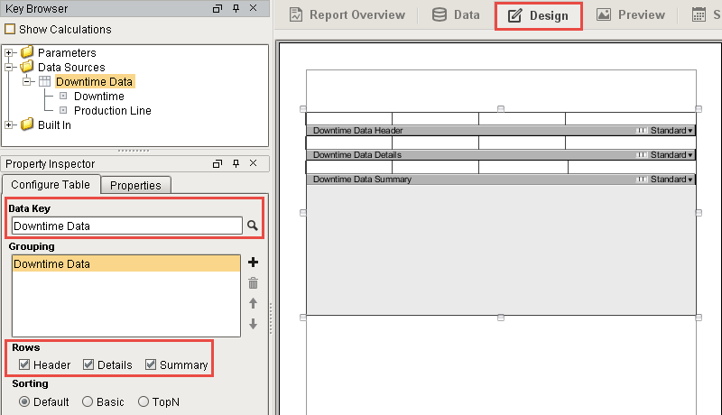

  1. Go to the Design panel, and drag a Table component into the page.
  2. From the Key Browser, expand the Datasources folder, and drag your data source (i.e., Downtime Data) into the Data Key field of the Configure Table tab of the Property Inspector.
  3. Add Header and Summary rows by marking the checkboxes.

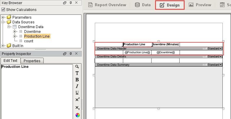

  4. Now, let's configure the data in the Table. With the Table still selected, drag each of the data keys to a cell on the table above the Data Details row: (i.e., Production Line, and Downtime).
  5. Next, let's add column headers by selecting a cell above one of our details cells, and enter the appropriate column header name (i.e., Production Line, and Downtime [Minutes]). You can change the font style, size, and color using the functions on the right side of the Edit Text Tab. Bold the headers using the Bold button.

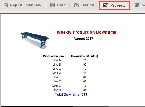

Preview a Report​
The Preview panel lets you validate that all your data is organize and formatted, and you're completely satisfied with how your data is presented in the report. Once your satisfied, you can schedule the report to be run and delivered automatically.
