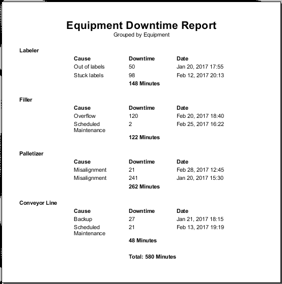

Grouping Data Inside of a Table Example​
This example begins with a table similar to the one created in the Report Workflow Tutorial. This example will demonstrate how to group the existing downtime report by equipment, collect downtime totals, and introduce some formatting techniques.

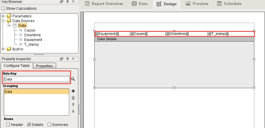

  2. In the Design panel, drag a Table component to your report.
  3. With the Table selected, drag the Data data source to the Data Key under the Configure Table tab of the Property Inspector.
  4. Drag each of the data keys (i.e., Equipment, Cause, Downtime, and T-Stamp) to any of the columns in the table row.

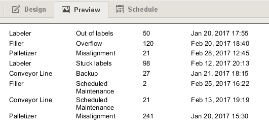

  5. Click on the Preview panel to see what the report looks like. You'll notice that all your data is there, but it's a little hard to read because it's not organized.

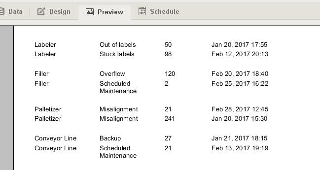

  6. Let's sort each row in the table by equipment and group all the equipment together. Go to the Property Editor, and in the Configure Table, click the Add icon next to Grouping, and a window will open with a list of data keys. Select the 'Equipment' row, and click OK. You'll notice 'Equipment' was added to the Grouping list, and an Equipment Details row was immediately added to the table.
  7. Go to the Preview panel to see that the report is now sorting by equipment name.

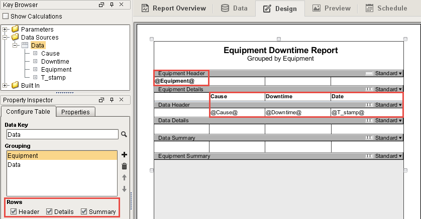

  8. Let's remove the Equipment Name from each row in the table and add a Header. Go to the Design panel and cut '@Equipment@' from the Data Details row and paste it in the Equipment Details row. You can bold it to make it stand out.
  9. While the table component is selected, go to the Configure Table tab in the Property Inspector and select the Equipment item in the grouping list and check both the Header and Summary boxes. Then select the Data group and select the Header and Summary checkboxes for it.
  10. Next, make the Equipment header an unstructured row and add text as a title for your report using the Text Shape in the component palette. Unstructuring the row allows you to easily center the title of your report.
  11. Now add header text for each of the Data Details columns (Cause, Downtime, and Date) by typing into the Data Header row.

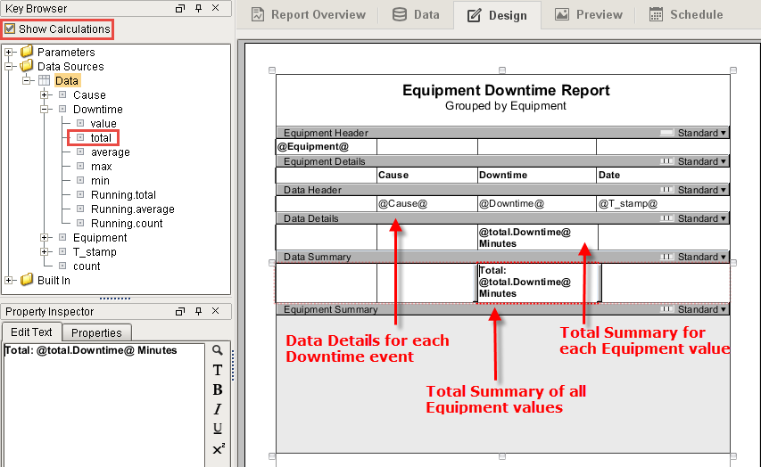

  12. Set the Show Calculations checkbox at the top of the Key Browser. Drill down into the Downtime column and drag the '@total.downtime@' to both the Data Summary and Equipment Summary rows. You can also add any text outside of the @ symbols. In this example, we added 'minutes' after the total downtime in our cell to '@total.downtime@ minutes'.
  13. Lastly, do the same in the Equipment Summary row. We also added the word "Total" to the beginning of the cell: 'Total: @total.downtime@ minutes'.
    note
    In any Summary row, '@total.Downtime@' is a sum of all downtime at that level of grouping; (i.e, in the Data Summary row it is the total downtime grouped by equipment. In the Equipment Summary row, '@total.Downtime@' is the sum of all downtime for all equipment groupings).
  14. Click over to the Preview panel to check out your report. If you want to make any changes, go back to the Design panel to update your report. Notice that the 'total' data key respects both groupings.
