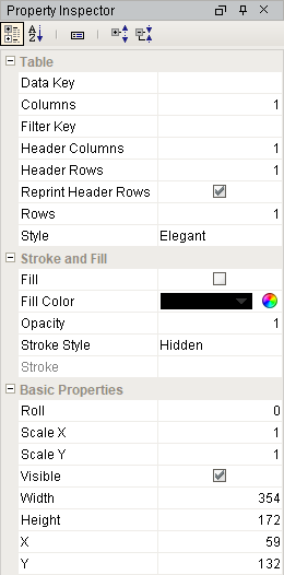

Table Properties​
PropertyDescriptionCategory
Data KeyThe data key associated with this Tabular component. Should be the data key of a data source that contains rows, such as a query.Table
ColumnsNumber of columns.Table
Filter KeyA key or expression used to prune the underlying data source's rows down. If not blank, only rows for which this key expression evaluates to true will be included.Table
Header ColumnsNumber of Header Columns.Table
Header RowsNumber of Header Rows.Table
Reprint Header RowsEnable header row printing when pagination occurs.Table
RowsNumber of Rows.Table
StyleGive the CrossTab or Simple Table a pre-configured style.
  • None
  • Classic 1 through Classic 3
  • Default
  • Elegant - with double border around the table.
  • Grid 1 through Grid 8
  • List 1 through List 6
  • Professional
  • Simple 1 through Simple 6
The Style section below shows several examples of some of the style templates you can choose from.
Table
FillIf true, the shape will fill its space with color.Stroke and Fill
Fill ColorIf Fill is selected, the color that will fill the shape.Stroke and Fill
OpacityHow opaque the fill color is, between 0 and 1.Stroke and Fill
Stroke StyleWhat style of stroke or border to use: Hidden, Shape Outline, Border, or Double. To learn more about stroke styles, refer to Stroke and Fill Properties.Stroke and Fill
StrokeDetails for the chosen stroke. Each Stroke has its own properties depending on the Stroke Style chosen.Stroke and Fill
RollNumber of degrees this shape is rotated clockwise.Basic Properties
Scale XAmount to scale the width of this shape. 1 is scale to 100%.Basic Properties
Scale YAmount to scale the height of this shape. 1 is scale to 100%.Basic Properties
VisibleIf true, the shape will be visible.Basic Properties
WidthWidth of this shape in pixels.Basic Properties
HeightHeight of this shape in pixels.Basic Properties
XHorizontal distance in pixels between the left edge of this shape to the left edge of the page.Basic Properties
YVertical distance in pixels between the upper edge of this shape to the top edge of the page.Basic Properties

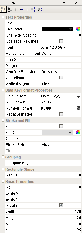

Cell Properties​
TextText to display in the shape.Text Properties
Text ColorColor of the text.Text Properties
Character SpacingAmount of extra spacing to add between characters. Negative spacing makes characters closer together.Text Properties
Coalesce NewlinesIf true, consecutive line breaks will be merged into one.Text Properties
FontFont to use for the text.Text Properties
Horizontal AlignmentHorizontal Alignment for text: Left; Right; Center; Full.Text Properties
Line SpacingSpacing between lines of text. 1 is single spacing, 2 is double spacing, etc.Text Properties
MarginMargin between texts and bounds of shape in pixels. Format is top: left: bottom; right.Text Properties
Overflow BehaviorHow text that overflows the bounds of the shape should be handled.
  • Paginate - text is pushed to the next page if the number of characters exceed the shape.
  • Shrink text to fit - text fits into the shape, and the font is smaller when previewed or printed.
  • Grow row - text fits into the shape, and shows when the shape is expanded, previewed, or printed.
Text Properties
UnderlinedIf true, use underlined text.Text Properties
Vertical AlignmentVertical alignment for text: Top; Middle; Bottom.Text Properties
Date FormatFormats to use for dates in this shape.Data Key and Format Properties
Null FormatFormats to use for null values in this shape.Data Key and Format Properties
Number FormatFormats to use for numbers in this shape.Data Key and Format Properties
Negative in RedIf true, show negative numbers in red.Data Key and Format Properties
GroupingGrouping Key will add a row or column for each Grouping the key generates.Grouping
RadiusAmount to radius the corners of this shape.Rectangle Shape
XHorizontal distance in pixels between the left edge of this shape and the left edge of the page.Basic Properties
YVertical distance in pixels between the upper edge of this shape and the top edge of the page.Basic Properties

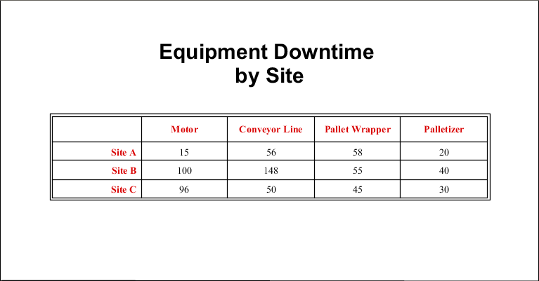

Example​
The Elegant Style template was used for this CrossTab table in a report. This CrossTab Table shows the downtime in minutes for each piece of equipment at each site.
Downtime Dataset - used for this CrossTab Table example
Equipment,Time,Site
Motor, 15, Site A
Motor, 23, Site A
Conveyor Line, 148, Site B
Pallet Wrapper, 58, Site A
Motor, 96, Site C
Conveyor Line, 23, Site B
Palletizer, 40, Site B
Palletizer, 30, Site C
Conveyor Line, 56, Site A
Conveyor Line, 50, Site C
Pallet Wrapper, 45, Site C
Motor, 43, Site C
Palletizer, 20, Site A
Pallet Wrapper, 55, Site B
Motor, 100, Site B
The data keys were used to populate the CrossTab Table with data. The property values used to configure the CrossTab Table are shown in the property list.
