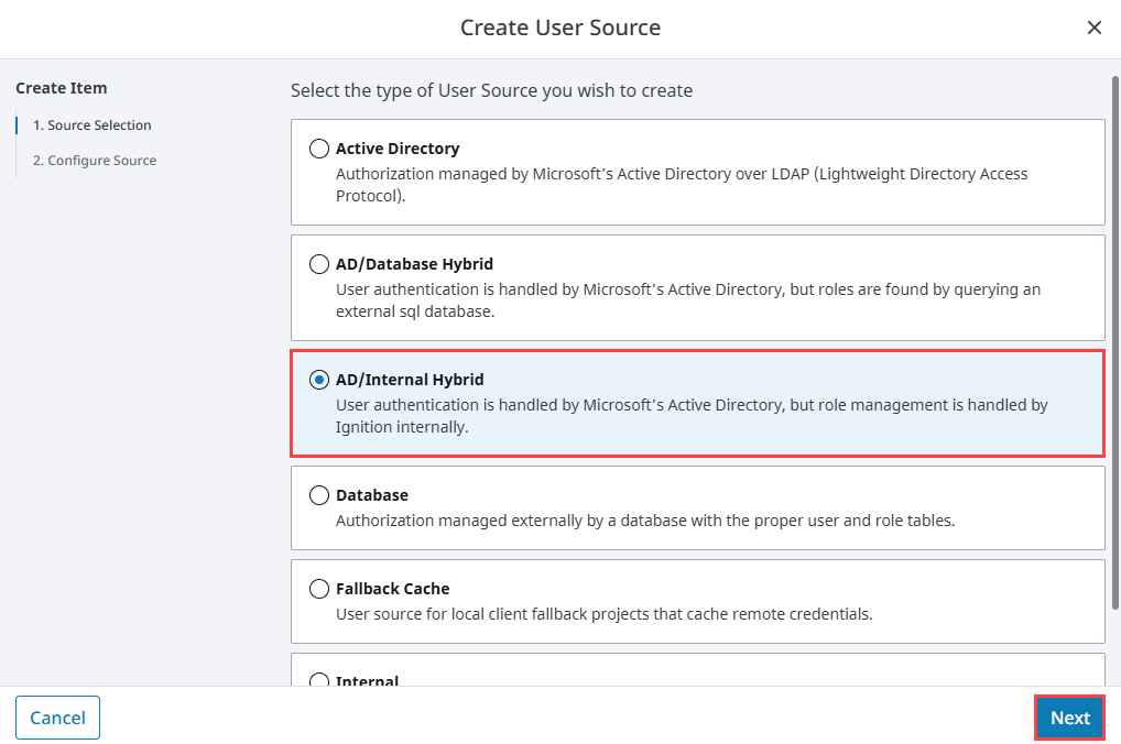

  1. On the Gateway webpage, under the Platform tab, go to Security > User Sources. The User Sources page will be displayed. Click Create User Source +.
  2. Choose the AD/Internal Hybrid authentication type, and click Next.
  3. The Configure Source form will open. Some properties are optional depending on how you set up your profile. Details on the General Properties can be found on the User Sources page. Active Directory properties are listed in the table below.
  4. Click Create User Source to save the new user source.
