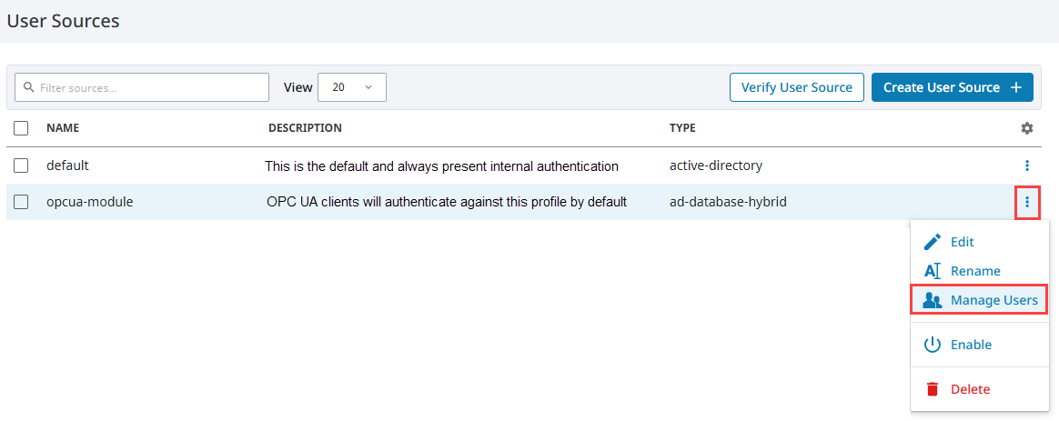

  2. Navigate to Security > User Sources.
  3. Click on the three dots menu and select Manage Users for the User Source you want to manage.

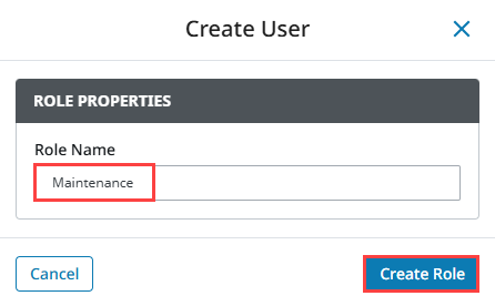

  4. Click the Roles tab and click Create Role +.
  5. Name the role by entering it in the Role Name field, and click Create Role. The role is now available to be associated with specific users.

  2. Click the three dots menu and select Manage Users for the User Source you want to manage.

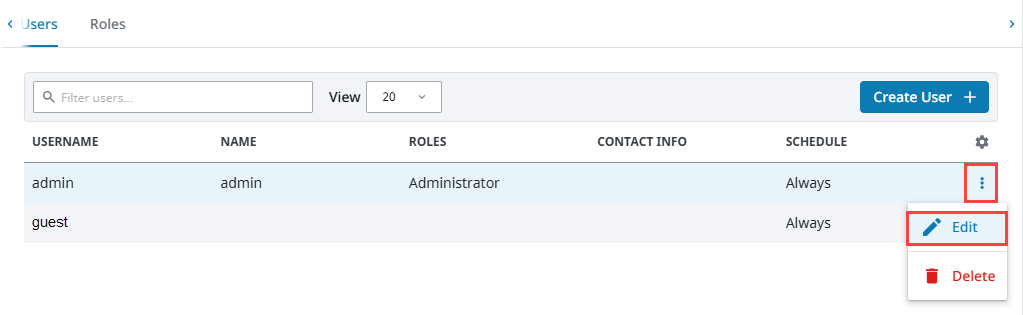

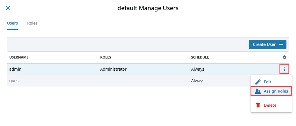

  3. Click the three dots menu and select Assign Roles for the User you want to edit.

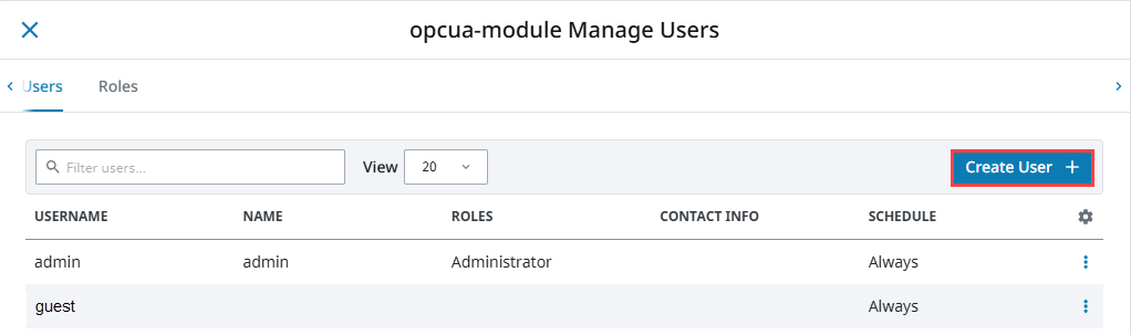

    • If you need to create a User for a role to be assigned to, select the Create User + button. Enter the user properties you want this user to have, click Create User, and then select Assign Roles from the three dots dropdown for the User to continue this procedure.
  4. Select the role(s) that you want this user to have from the supplied Roles list.
  5. Click Save Changes. The user now has the privileges associated with the selected role(s).
