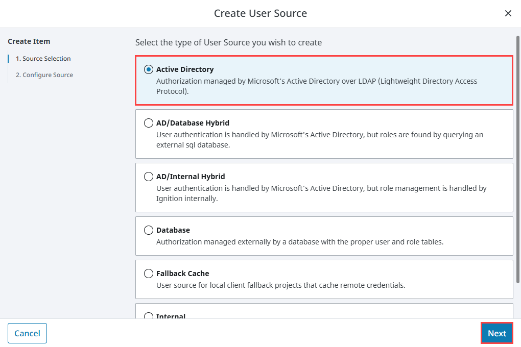

To Create an Active Directory User Source​
To configure an Active Directory User Source, you must specify the host that is acting as your primary domain controller. You can also use a secondary domain controller in case the primary is unavailable. You'll also need to specify the name of the domain and credentials for the Gateway itself to use: the Gateway needs a user account to interact with the AD server, even when it's simply querying for a list of roles.
note
When using Active Directory User Source, you may need to consult with your internal IT Department to get the required information to complete your user source setup. These settings are common to AD (not specific to Ignition), and your IT department will know what values to supply to each property.
  1. On the Gateway Webpage, under the Platform section, go to Security > User Sources. The User Sources page will be displayed. Click Create User Source +.
  2. Choose the Active Directory authentication type, and click Next.
  3. The Configure Source form will be displayed. Some properties are optional. In the very least, you must specify the following: Domain, Gateway Username, Password, Primary Domain Controller Host.
  4. Click Create User Source to create the User Source.

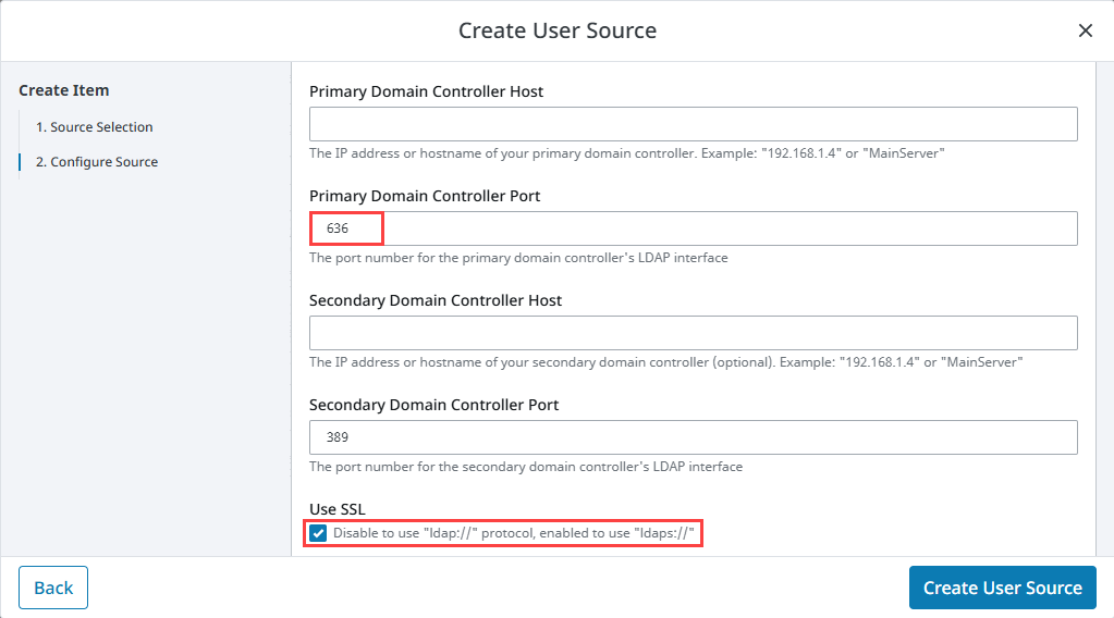

Connect AD over SSL​
For additional security, you can adjust the Active Directory settings to enable SSL since LDAP is not encrypted by default. The default port for LDAP is port 389, but LDAPS uses port 636 and establishes SSL upon connecting.
  2. Click Create User Source + on the User Sources page.
  3. Choose the Active Directory authentication type, and click Next.
  4. Change the Primary Domain Controller Port to 636.
  5. Check Use SSL to enable β€œldaps://”.
  6. Click the Show Advanced + button to expand advanced properties.
  7. Under LDAP Search Properties, change the Security Protocol to SSL.
  8. Fill in the remaining required properties as needed and click Create User Source.
If you try to query or authenticate against the AD server at this point, you will receive the following error:
Caused by: javax.net.ssl.SSLHandshakeException: sun.security.validator.ValidatorException: PKIX path building failed: sun.security.provider.certpath.SunCertPathBuilderException: unable to find valid certification path to requested target
This error indicates Ignition was unable find a valid certificate generated from the AD server, and therefore cannot validate the AD server's identity. Work with IT to obtain a certificate from the AD server. This certificate must be added to the data/certificates/supplemental directory and then imported into the Java cacerts keystore. Once the certificate is added, restart the Gateway.
