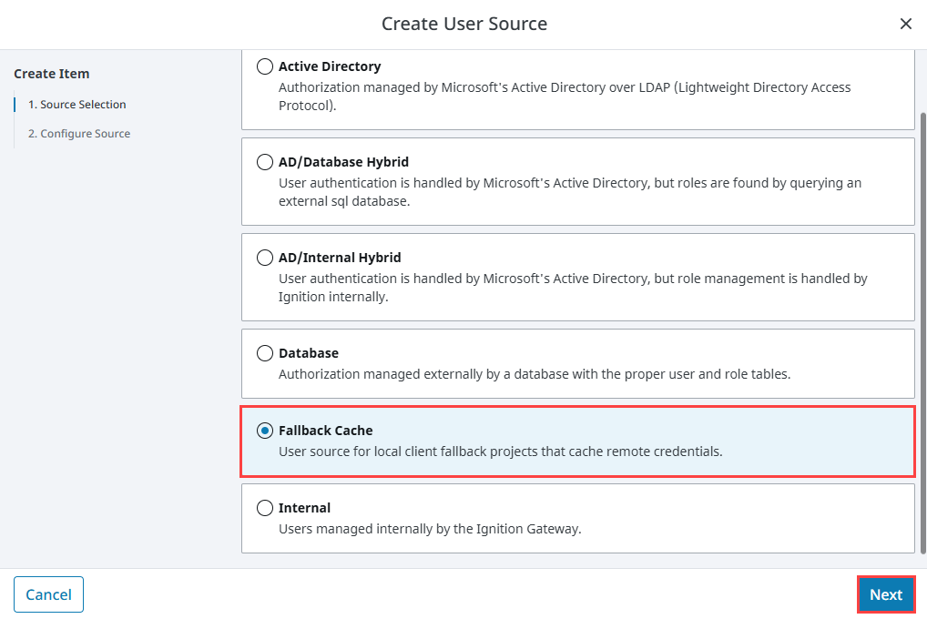

The Fallback Cache User Source is created in a similar fashion to any other User Source:
  1. On the Gateway Webpage, go to the Platform tab. Select Security > User Sources.
  2. Click on Create User Source +.
  3. Select the Fallback Cache option and click the Next button.
  4. Type in a name for the new User Source and fill in the remaining properties as needed. Details on the General Properties can be found on the User Sources page.
  5. Click Create User Source.
