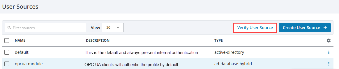

  2. Choose Security > User Sources from the menu on the left. The User Sources page is displayed.
  3. Select Verify User Source.

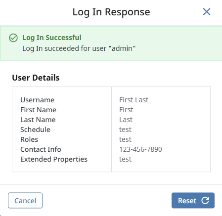

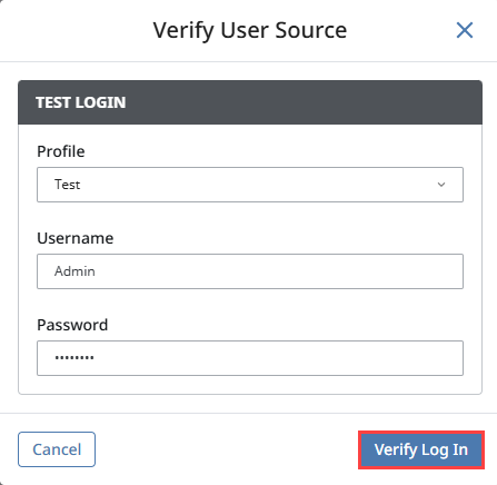

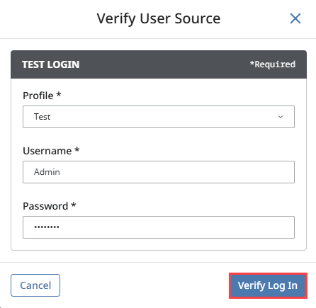

  4. The Verify User Source form will appear. Choose a Profile from the dropdown list. Enter a Username and Password. Click Test Login. Ignition will test the credentials then display the results of the validity test.
If the Login is incorrect, an error message will appear stating that the Login failed for a specified user. If the Login is correct, a successful message will appear for a specified user along with their information.
