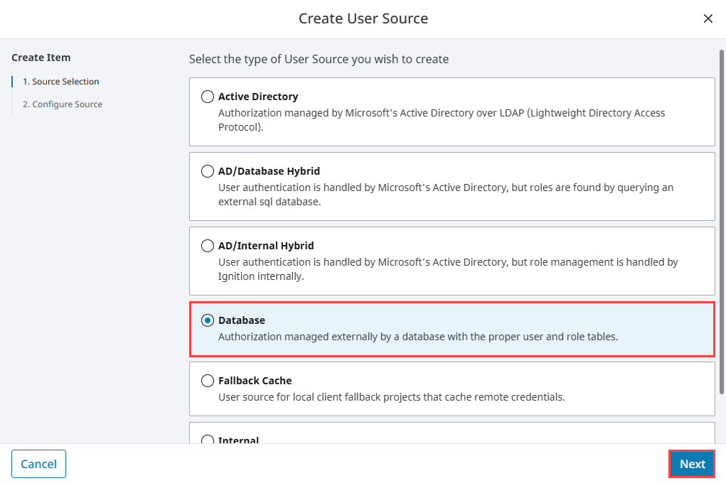

To Create a Database User Source​
  1. On the Gateway Webpage under the Platform tab, go Security > User Sources. The User Sources page will be displayed.
  2. Click Create User Source +.
  3. Choose the Database authentication type, and click Next.

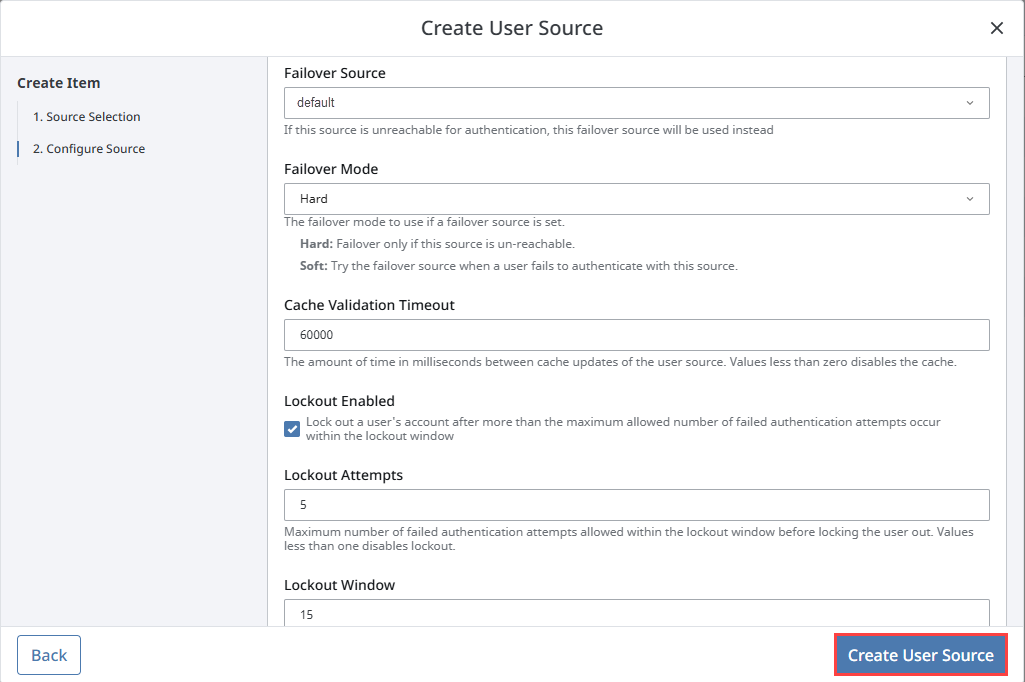

  4. The Configure Source form will open. Some properties are optional, but if you're using Automatic mode, enter the following properties as appropriate.
    • Name: DBAuth
    • Failover Source: default
    • Failover Mode: Hard
    • Database: MySQL
    • Mode: Automatic
    • Tablename Prefix: auth_ (You can leave this field blank, but if you use a prefix when the tables get created, they will contain the specified prefix in their name).
    When finished, click Create User Source.
