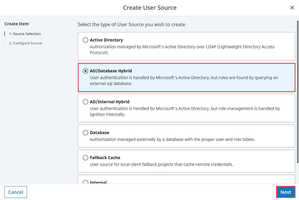

Creating an AD/Database Hybrid User Source​
  1. On the Gateway Webpage, under the Platform section, go to Security > User Sources. The User Sources page will be displayed.
  2. Click Create User Source +.
  3. Choose the AD/Database Hybrid authentication type, and click Next.
    note
    When using AD/Database Hybrid User Source, you may need to consult with your internal IT Department to get the required information to complete your user source setup.
  4. The User Source Setup window will display configuration settings. Some properties are optional depending on how you set up your profile. Details on the General Properties can be found on the User Sources page. The Active Directory Properties and Database properties are listed in the tables below.
  5. Click Create User Source to save the new user source.
