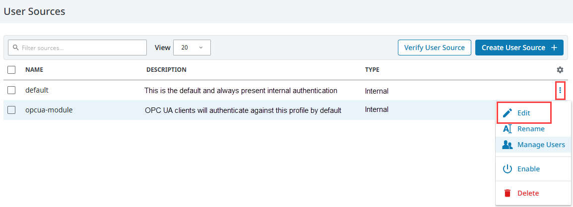

The Internal User Source is fully manageable from within Ignition. You can access User Sources from the Gateway Webpage under the Platform section, Security > User Sources. Click the three dot menu and select Edit.

  1. From the Platform tab on the Gateway Webpage, select Security > User Sources.
  2. Click the three dot menu and select Edit for the User Source you want to update.

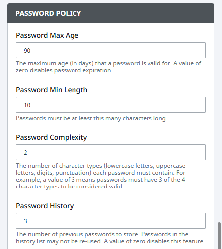

  3. Scroll down to the Password Policy section. You can change the default password policies by entering the appropriate password values to support your password policies.

NameDescription
Password Maximum AgeThe maximum age in days that the password will still be valid. After the number of days has past, when the user tries to login, it will prompt them to change their password. A value of 0 will disable this feature. This property will also affect password age and expiration when you are using Ignition's Internal Identity Provider (IdP). If you try to log in after the expiration period, you will be redirected and prompted to update your password.
Password Minimum LengthThe minimum amount of characters that a password must contain to be considered valid. If the user tries to make a shorter password, it will not allow it, and let them know that it does not meet the minimum length requirements. Default is 8.
Password ComplexityThis determines how complex a password must be. There are four character types: lowercase letter, uppercase letter, digits, and special characters. The value here determines how many of those character types must be present at least once in the password for it to be considered valid. Default is 3.
Password HistoryDetermines the number of previously used passwords to store. When users make a new password, old passwords can not be re-used. A value of zero disables this functionality. History is only stored while this setting is turned on, so any passwords used while this is off can be re-used when history is turned back on. Default is 0 (disabled).
Prohibit PasswordIf enabled, passwords may not contain any form of the word "password". This includes:
  • password
  • pass
  • word
  • pwd
  • passwd
  • pword
Default is true.
Prohibit UsernameIf enabled, passwords may not contain any form of the username. Default is true.
Maximum Consecutive Repeated CharactersThe maximum number of consecutive repeated characters allowed in a password. Set to 0 to disable. Default is 3.
