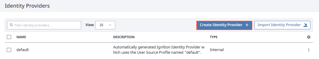

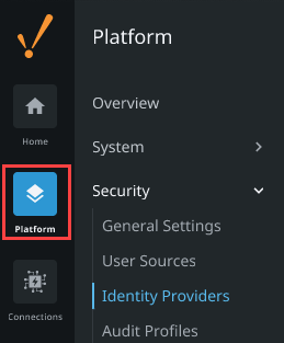

  1. On the Gateway Webpage, click on the Platform tab.
  2. Under the Security section, click on Identity Providers. The Identity Providers page is displayed. This page will list all IdPs that have been configured. You can filter by name or adjust the number of IdPs displayed in the view.

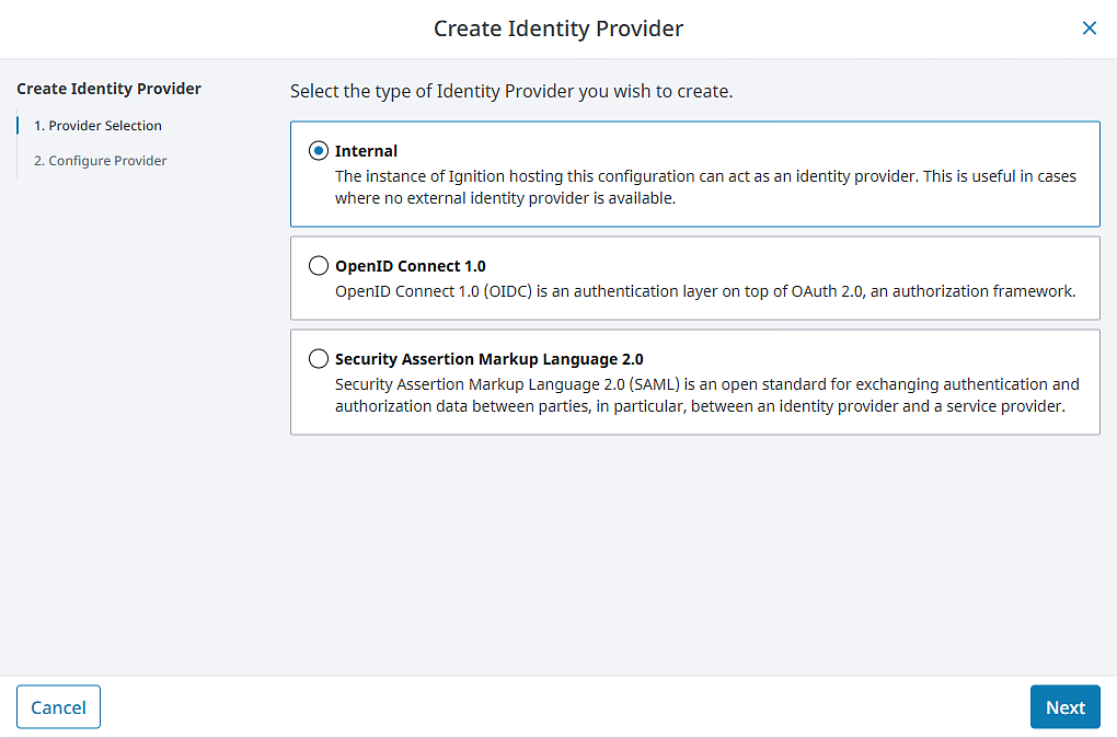

  3. Click on Create Identity Provider +.

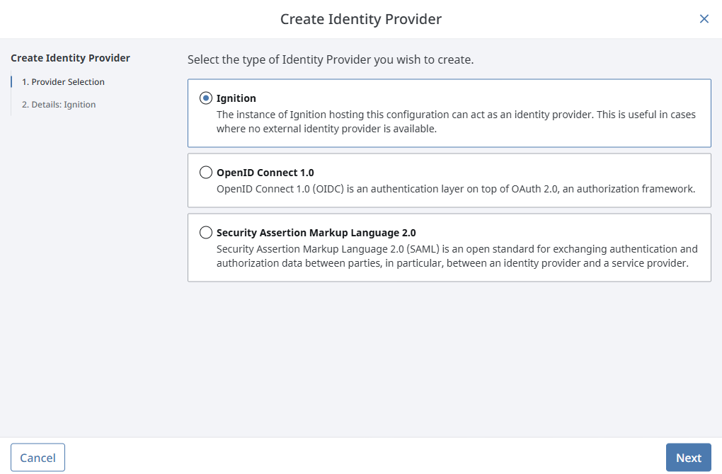

  4. Choose the type of provider. The current options are Internal, OpenID Connect 1.0 or Security Assertion Markup Language 2.0 (SAML).
  5. Click the Next button.
  6. Configure the adapter. This step varies based on the type of provider. Please see the reference tables below for a description of properties.
  7. Once you've filled in the properties, click Create Identity Provider.

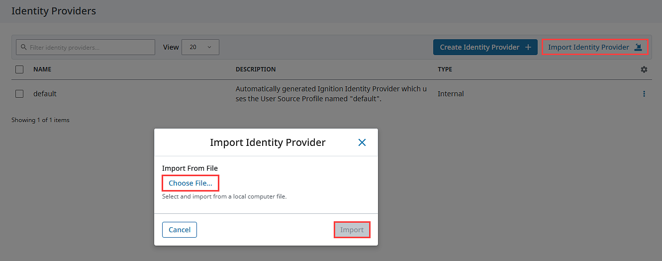

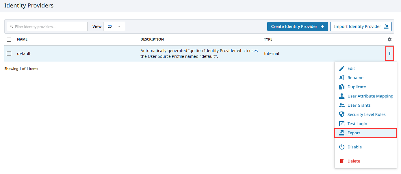

Import/Export an Identity Provider​
Another option for adding an Identity Provider to your Gateway is to import one. You must first have a file of an existing configuration, which can be taken from a Gateway by expanding the three dots menu for the desired Identity Provider and selecting Export.
New in 8.3.3
8.1 Gateway Identity Provider exports can now be successfully imported on an 8.3 Gateway. Prior to 8.3.3, importing Identity Providers from an 8.1 Gateway was not supported.
Now, from the Identity Providers page on the Gateway you want to import on, you can select the Import Identity Provider option. Click Choose File... from the Import Identity Provider popup. Once you have your file loaded, select Import.
A success message will appear at the top of the screen and the Identity Provider will now be listed on the page. Note that if your import file has any missing configuration values, they will be imported as the default values.

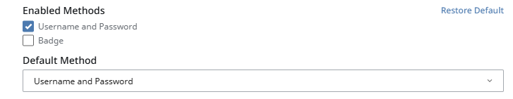

Authentication MethodsYou can opt into Badge-based authentication for the IdP by enabling the Badge method. The Default Method setting determines which option users first see when attempting to authenticate against the IdP.

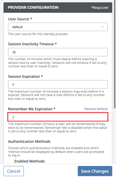

To set up Remember me, do the steps that follow:

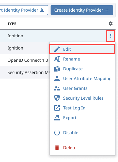

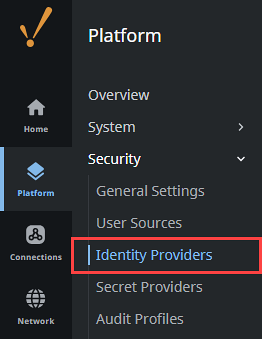

  1. On the Gateway Webpage, click on the Platform tab. Scroll down to Security > Identity Providers.
  2. For the Ignition Identity Provider you'd like to configure, click on the three dots menu and choose Edit.
  3. On the Edit panel, scroll down to the Provider Configuration section.
  4. For the Remember Me Expiration option, enter a value greater than zero. For this example, we set the option to two hours.
  5. Click Save Changes.

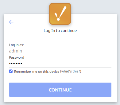

To enable Remember Me for your login, do a test login:
  2. For the Ignition Identity Provider you'd like to configure, click on the three dots menu and choose Test Login.
  3. Enter your password and select the Remember Me option.
  4. Click the Continue button.
  5. Your login will now be remembered for the amount of hours that were specified in the Remember Me Expiration setting, which in this example was 2 hours.
