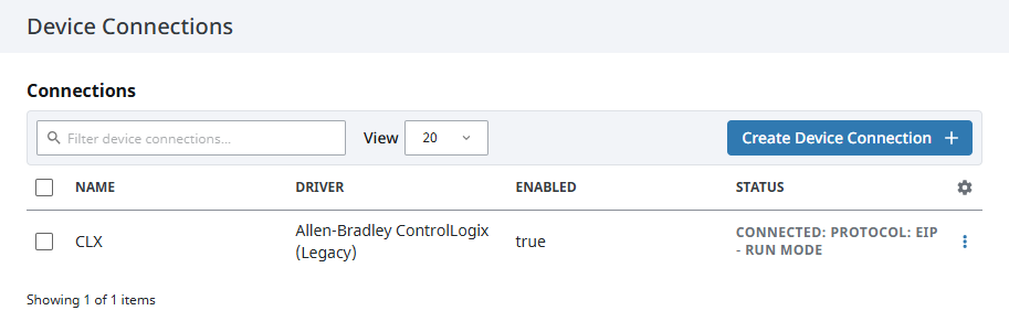

  1. On the Gateway, go to Connections > Devices > Connections.

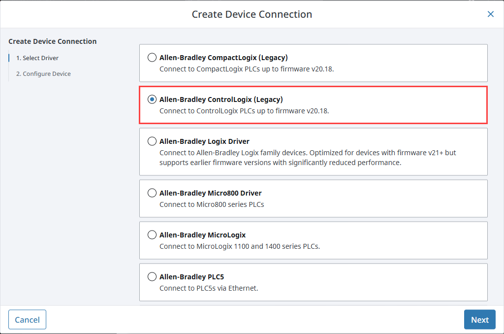

  2. Click Create Device Connection +.
  3. Select Allen-Bradley ControlLogix (Legacy) and click Next.

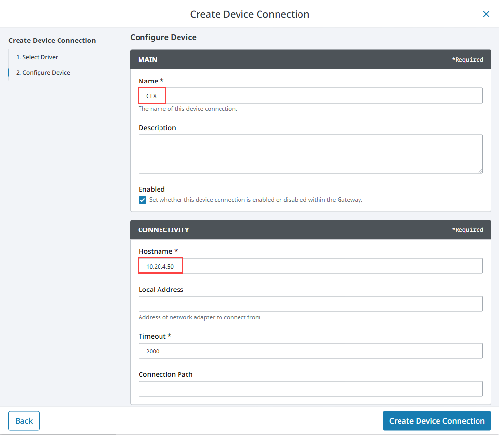

  4. On the Configure Device screen, enter the required fields:
    • Name: CLX
    • Hostname: The IP address of the PLC (e.g., 10.20.4.50)
  5. Click Create Device Connection.
The device will be listed now on the Connections page. The status will initially show Disconnected, but will move to a Connected state.
Device Connection Settings​
General​
NameDescription
NameA user-defined name for the device. This name appears in OPC item paths and the Devices list. Name must begin with an underscore or a letter, and cannot include special characters.
DescriptionAn optional description to help identify the device.
EnabledWhen selected, the device is active and available for use in the system.
Connectivity​
NameDescription
HostnameIP address of the Ethernet module (e.g., 1756-ENET) used to connect to the ControlLogix processor.
Local AddressIP address of the local network adapter to bind to. Leave blank to auto-select.
TimeoutTimeout in milliseconds for a request to receive a response from the device.
Connection PathUsed to define a route to the ControlLogix or downstream PLC-5 processor. See Allen-Bradley Connection Paths for more information.

Supported Connection Methods​
This driver supports ControlLogix 5500 devices connected through a 1756-ENET/A or 1756-ENET/B module.

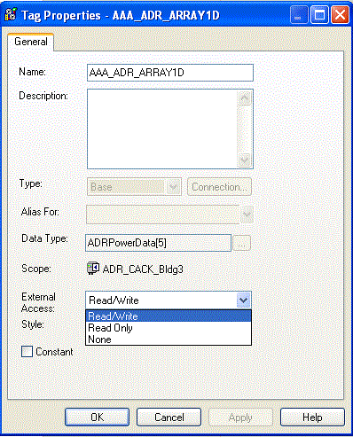

Considerations for ControlLogix Settings​
When the ControlLogix processor External Access setting for a tag is set to None, the tag information is not returned to Ignition during reading of tag information.
Using RSLogix 5000, change the External Access setting to either Read Only or Read/Write for the tag to show in the Ignition browse results.
