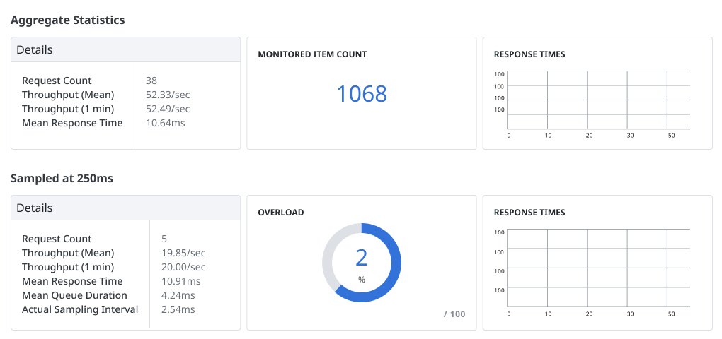

Device Detailsβ
Some devices have additional metrics you can view on the Gateway Connections > Devices > Connections page. To see these metrics, click the desired device connection's three dots menu and select View Details.
Aggregate Statisticsβ
The metrics below include various aggregate statistics and monitored item count.
| Attribute | Description |
| Request Count | The number of requests currently scheduled from the driver to the device. A request is a group of tags or items that the driver has grouped together to be read at the same time. Each driver forms these groups based on the protocol being used, and occasionally configuration settings in the driver. |
| Throughput (Mean) | The average number of requests that come through per second, starting from when the device was last initialized. This value will be reset if the device connection is edited and saved, since this causes the device connection to reinitialize. |
| Throughput (1 min) | The average number of requests that come through per second within the last minute. |
| Mean Response Time | The average time it takes for Ignition to get a response from the device. This value is an average based off the Response Times chart. |
| Monitored Item Count | The total number of items that the device connection is subscribed to, including any Device Diagnostic tags listed above. |

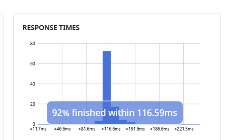

Response Times Chartβ
The Details panel also includes a bar chart that illustrates the distribution of requests by grouping them based on their recorded response times. The x-axis measures the request group's response time in milliseconds. The y-axis measures the percentage of requests that fall within a response time group, calculated from the total number of recorded response times.
When hovering over the bar chart, a tooltip will display the total percentage of requests that were completed within the time frame you are hovering over. This tooltip value can be different than each individual bar's y-axis value, since the tooltip takes the aggregate y-axis values of the requests that are within the same group or faster.

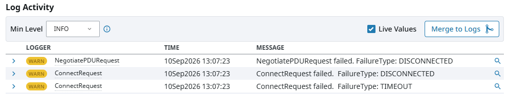

Log Activityβ
The Log Activity section displays loggers related to the device connection. Changing the Min Level will filter out any logs that do not meet the set logging level. Options include:
- INFO
- DEBUG
- TRACE
You can also toggle whether the activity updates with live values, or merge your device connection logs with the Gateway Diagnostic logs.
