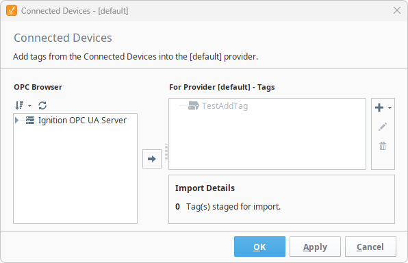

  1. In your Tag Browser, click on the Add Tag Browser Add Icon icon, then click on Browse Devices... Browse Devices Icon. The Connected Devices popup window will open.
    Browsing Points with DNP3 Example Step 1

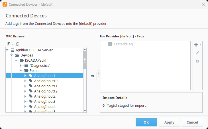

  2. Navigate to the tag you want to import. In this example, since we want AnalogInput1 within our connected device, we'll go through Ignition OPC UA Server > Devices > [SCADAPack] > Points > AnalogInput1.
    Browsing Points with DNP3 Example Step 2

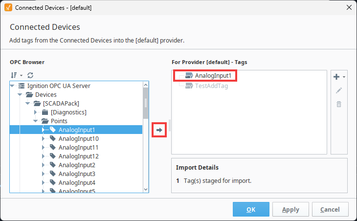

  3. Select the tag or folder to import and add it to your Tag Provider by clicking on the Add Connected Devices Window Add Icon icon. This will stage the tag for when you are ready to import, in case you want to add any other tags or folders.
    Browsing Points with DNP3 Example Step 3

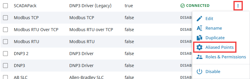

  1. Navigate to the Gateway Webpage > Connections > Devices > Connections.
  2. Click the three dots menu of the legacy DNP3 connection you want to add a data point for, then click Aliased Points.
    Browsing Points With Legacy DNP3 Example Step 2

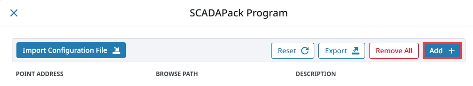

  3. The Program panel for your legacy DNP3 connection will open. Click on the Add + button on the top right of the panel. This will add a new entry to the table where you can specify an aliased point.
    Browsing Points With Legacy DNP3 Example Step 3

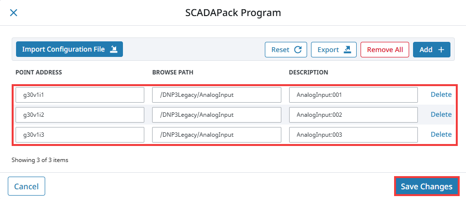

  4. Enter the information for the aliased point you want to map, then click Save Changes on the bottom right.
    Browsing Points With Legacy DNP3 Example Step 4
Your aliased point is now exposed to Ignition. You can now browse for this aliased point in the Tag Browser's Connected Devices window and add it to Ignition by following the Browsing Points with DNP3 Example above.
