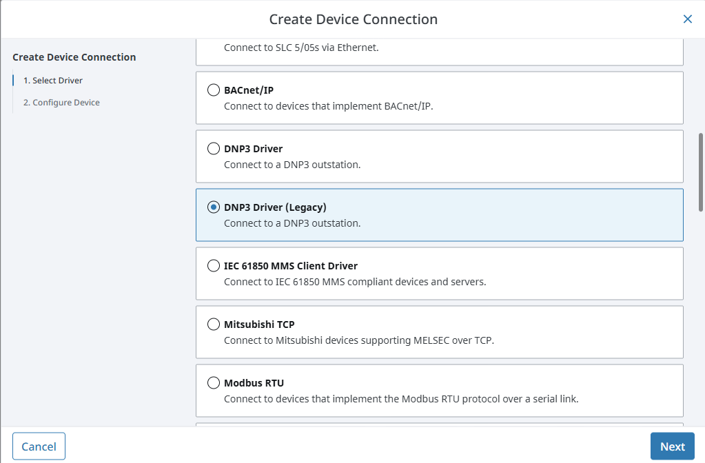

  1. On the Gateway, go to Connections > Devices > Connections.
  2. Click Create Device Connection +.

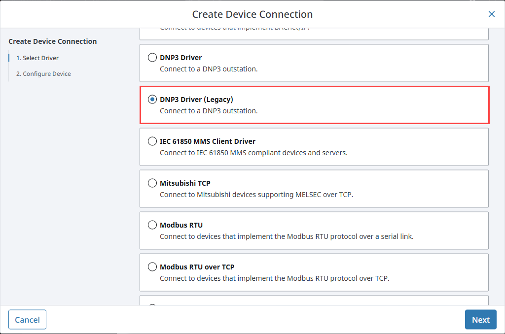

  3. Select DNP3 Driver (Legacy) from the list and click Next.

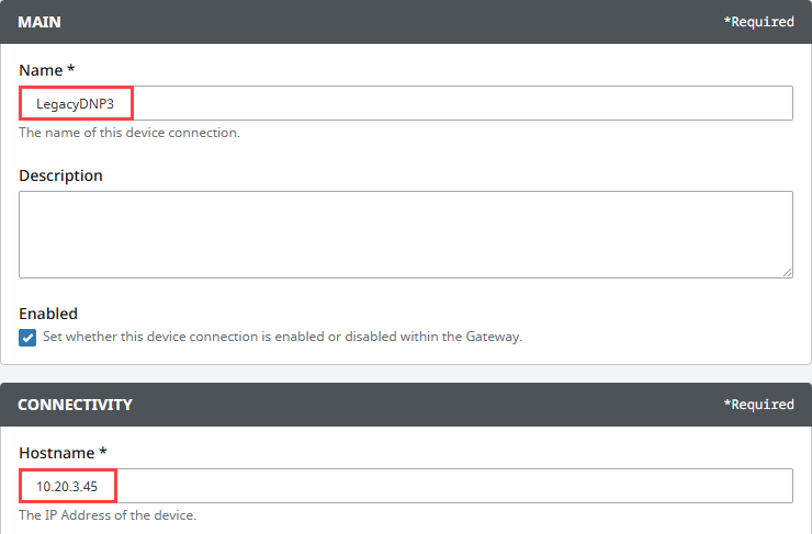

  4. On the Configure Device screen, enter the required fields:
    • Name: The desired name for the device (e.g., LegacyDNP3)
    • Hostname: The IP address of the PLC (e.g., 10.20.4.55)
  5. Click Create Device Connection.

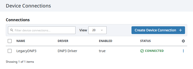

The device will be listed now on the Connections page. The status will initially show Disconnected, but will move to a Connected state.
