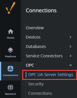

Settings for the server can be found under the Connections section of the Gateway Webpage. On the sidebar, locate OPC > OPC UA Server Settings.

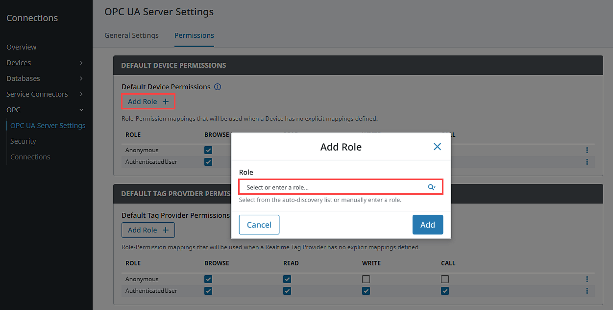

OPC UA Server Permissions​
The Permissions tab allows users to set role permissions for access to devices and exposed tags. Each role will have the options for Browse, Read, Write, and Call.
Click the Add Role option to select or enter a role. Roles already created for the opcua-module user source will be available to select from the dropdown. You can also enter a new role here to assign permissions, but then you will need to navigate to the Platform > Security > User Sources Gateway page to create a role of same name for the permissions to be applied to the desired opcua-module users.
After the role is added to the Permissions list, check the access levels you want to apply. Make sure to click Save Changes at the top of the page after any permissions update. You can remove roles by expanding the three dots menu and selecting Remove.

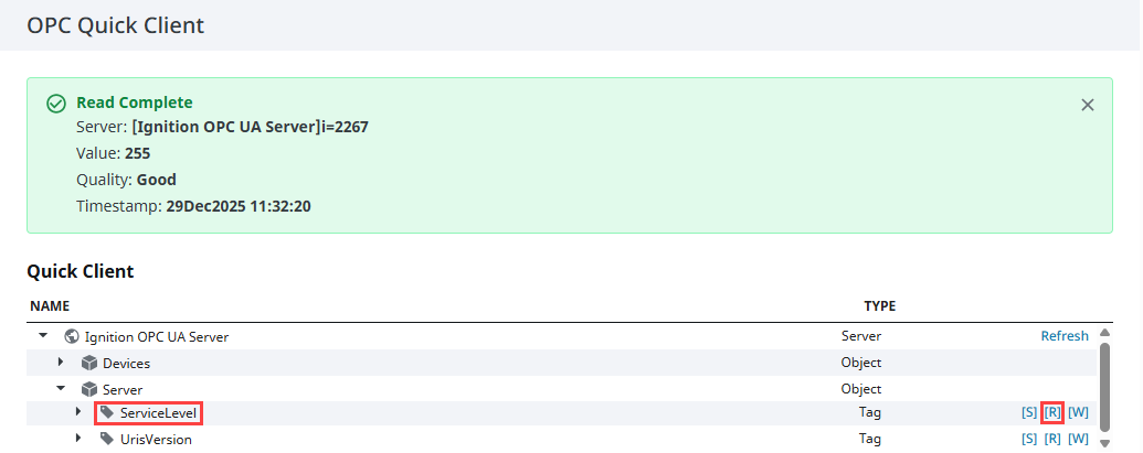

Verifying Redundancy State with the OPC Quick Client​
The OPC Quick Client can be used to verify which Gateway is currently active in a redundant Gateway pair by reading the OPC UA server's runtime status.
  1. Open the Gateway and navigate to Connections > OPC > Quick Client
  2. Expand Ignition OPC UA Server, then expand Server.
  3. Locate ServiceLevel, then click the [R] (Read) icon to display the results at the top of the page.
The ServiceLevel value indicates which Gateway is currently active. This value is read-only and reflects the current redundancy state.
Service LevelDescription
255The OPC UA server is running on the master Gateway and is currently active.
254The OPC UA server is running on the backup Gateway and is currently active.
1The OPC UA server is inactive.
note
In some network conditions, such as a temporary Gateway Network communication loss, both nodes may briefly report active values. This typically resolves once communication between the nodes is restored.

  1. Go to the Server Settings page for Ignition's OPC UA Server. This page is located on the Gateway webpage Connections > OPC UA > Server Settings.

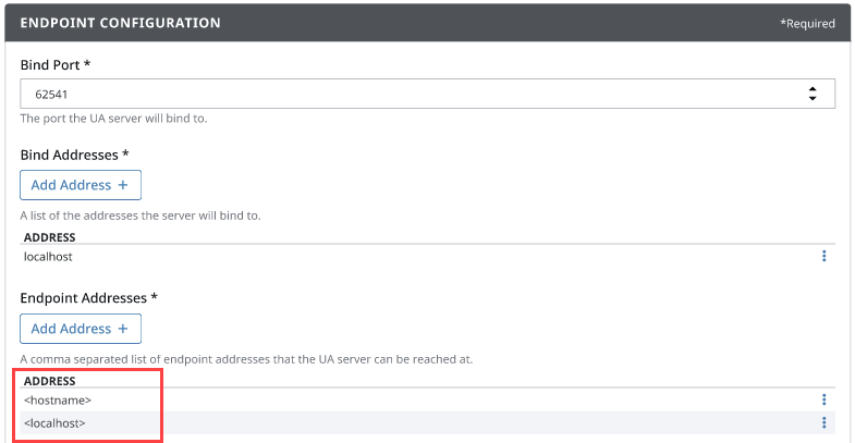

  2. Check your Endpoint Addresses setting. The default value for this setting is <hostname>,<localhost>. The IP address of the internal OPC UA Server can also be appended.
    Troubleshoot Faulted Connection Step 2
  3. Click Save Changes at the top of the page. After making changes to your settings, saving may help flush out any residual information.

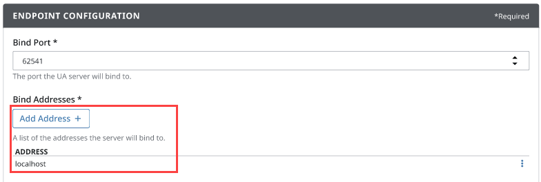

  4. Check your Bind Addresses. The default value for this setting is localhost. If you want to expose the OPC UA Server to external clients, you can use a value like 0.0.0.0 or the IP address of the computer. Click Save Changes.
