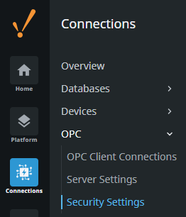

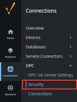

The Security Settings page is located under the Gateway's Connections section, under OPC > Security Settings:

  1. On the Gateway Webpage Connections tab, select OPC > Security Settings.

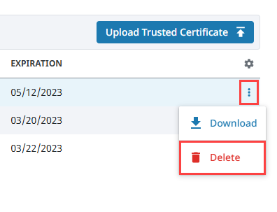

Delete a Trusted Certificate​
To delete a trusted certificate, do the following.
  1. Next to the certificate name, click the three dot menu and select Delete.
  2. The certificate is deleted.
To view more information about a trusted certificate, use the Expand icon.

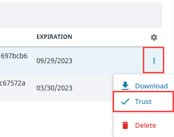

Quarantined Certificates​
If you import a certificate that is not trusted, it will appear under the Quarantined Certificates list. From here you can expand the certificate details, Trust the certificate, or Delete it.

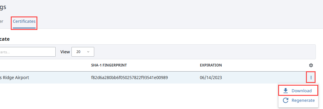

Certificates Tab​
The Certificates tab shows the trusted certificates for the OPC UA client and server on the Gateway. From this tab the certificates can be examined by expanding the dropdown. The certificates can be downloaded by clicking the three dot menu and selecting Download. This will perform the same action as downloading a certificate from the Client tab as described above.
Certificates Tab
The Certificates tab menu options also include a Regenerate option. Selecting this will create a new certificate.

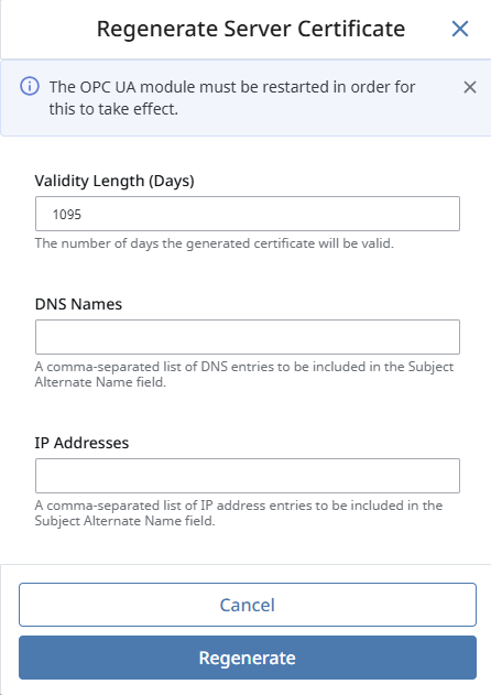

Regenerate Current Certificates​
All certificates have a definitive live span. For example, the default life span for an Ignition-generated OPC UA certificate is three years. Any OPC UA connection, even the default loopback connection to Ignition's own server, will stop working if the certificate expires or is invalid.
Regenerating the certificates creates a new certificate with an expiration date set for three years later. If your private key is somehow compromised, regenerating a Client or Server certificate also ensures that the private key will no longer work with the Ignition Gateway.
Newly regenerated certificates are automatically trusted by the Gateway issuing them.
Regenerating a Client certificate will allow you to specify the duration of the new certificate. In addition, regenerating a Server certificate will allow you to specify the duration, the DNS names, and IP addresses in the Subject Alternate Name (SAN) fields.
