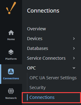

To access the Connections Details panel:
  1. Go to Connections > OPC > Connections.
  2. Click the three dots menu next to a connection and select View Details.

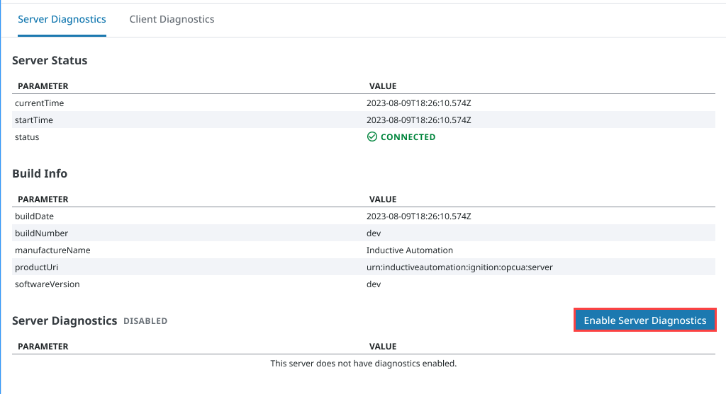

Server​
By default, server diagnostics are disabled since they can generate a considerable amount of network overhead and impact performance. To begin tracking server diagnostics, click Enable Server Diagnostics on the Server Diagnostics tab. Note that not all OPC UA servers support server diagnostics.
OPC Connections Page - Server
Changed in 8.3.9
Due to a Milo 1.1.6 upgrade, the OPC UA server library now enforces users to hold a ConfigureAdmin or SecurityAdmin role when enabling server diagnostics. New installations for versions 8.3.9+ will grant a ConfigureAdmin role to the default opcuauser automatically. If you have upgraded from 8.3.8 and earlier to 8.3.9 or later, this role will need to be manually added to the opcua-module User Source. See the Granting Roles section for more information on how to add ConfigureAdmin and SecurityAdmin roles.
A View Session Diagnostics option will appear when server diagnostics are enabled. Selecting this will allow you to inspect session and subscription activity.

  12. Expand the three dots menus to Disable and then Enable OPC connections so that the new role will take effect.
  13. Select View Details from the connection's three dots menu once the status returns to Connected.
  14. Click Enable Server Diagnostics.

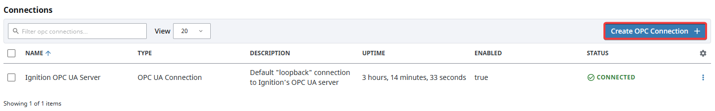

  1. On the Connections section of the Gateway Webpage, go to OPC > Connections. The OPC Connections page is displayed.
  2. Click on Create OPC Connection +. A popup wizard will appear.

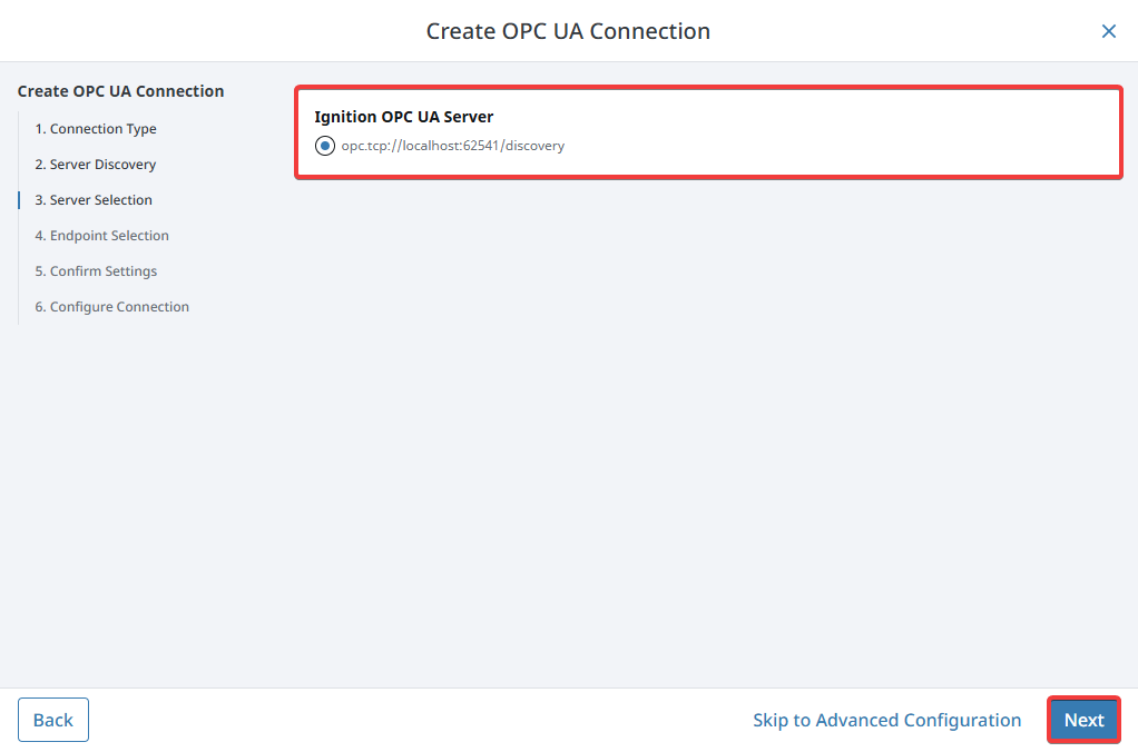

  6. Choose a server, then click Next.

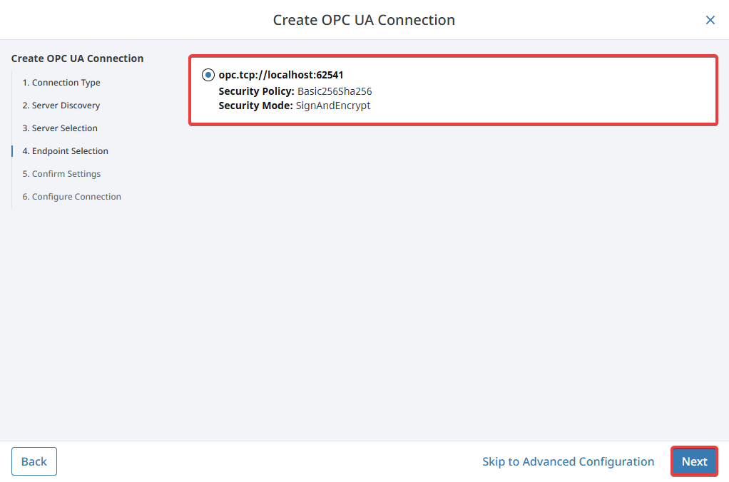

  7. Choose an endpoint, then click Next.

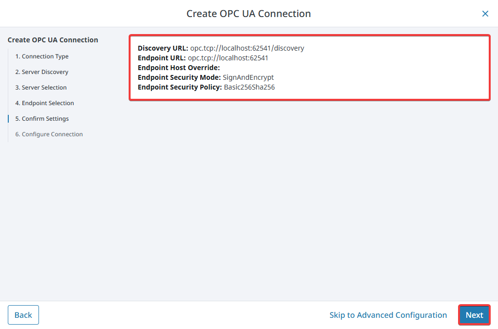

  8. A summary of your selections thus far will be displayed. Once you confirm your settings, click Next.

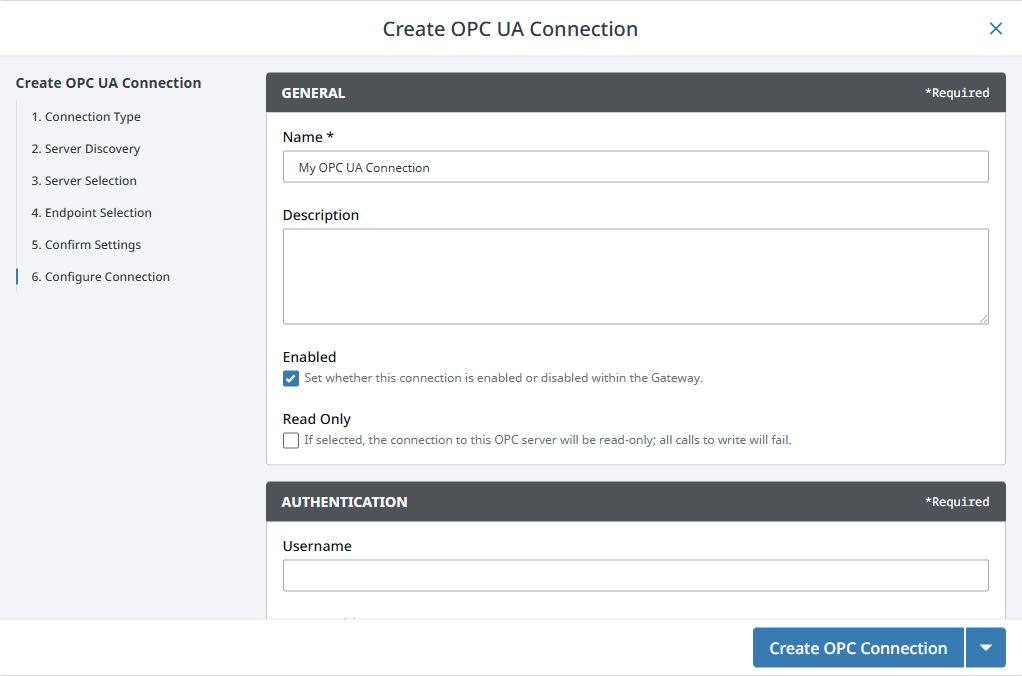

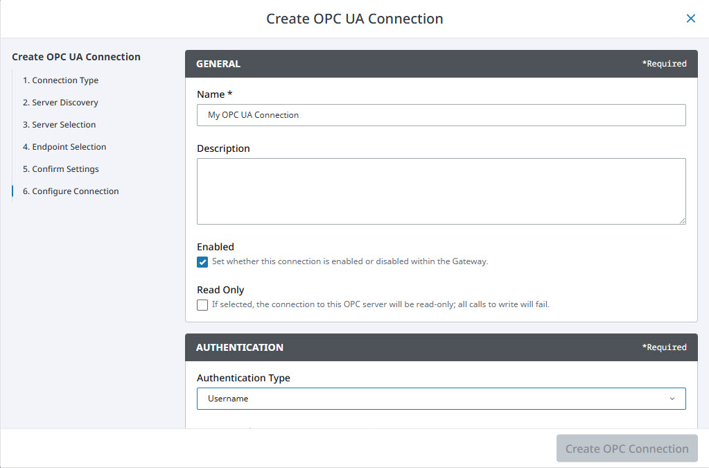

  12. On the Configure Connection page, give the connection a name. Some OPC UA servers may also require specific Authentication credentials. Check with the OPC UA server's documentation for more details. Credentials for Ignition's OPC UA server can be found on the Ignition's OPC UA Server page.
    Configuring OPC Client Connection Step 12
  13. Once all desired settings have been configured, click Create OPC Connection.

PropertyDescription
DescriptionShort description of this connection.
EnabledDisable the connection to the OPC server.
Read OnlyPuts the connection into read-only mode. All writes sent to this server will fail.

PropertyDescription
Authentication Type
Changed in 8.3.3
The Authentication Type field has replaced the Username/Password fields to additionally provide Anonymous and Certificate selections. Once an option has been chosen, relevant sub properties based on the Authentication Type will display.
  • Username: Requires a user and password to authenticate the connection. This is the default type.
