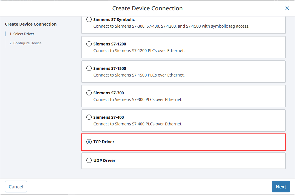

  1. On the Gateway, go to Connections > Devices > Connections.
  2. Click Create Device Connection +.
  3. Select TCP Driver from the list and click Next.

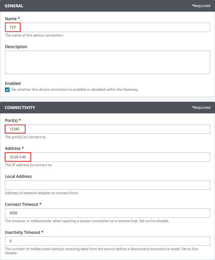

  4. On the Configure Device screen, enter the required fields:
    • Name: The desired name for the device (e.g., TCP)
    • Port(s): The TCP port(s) to connect to, comma-separated. (e.g., 12345)
    • Address: The IP address of the device (e.g., 10.20.3.45)

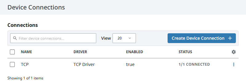

  5. Click Create Device Connection.
The device will be listed now on the Connections page. The status will initially show Disconnected, but will move to a Connected state.

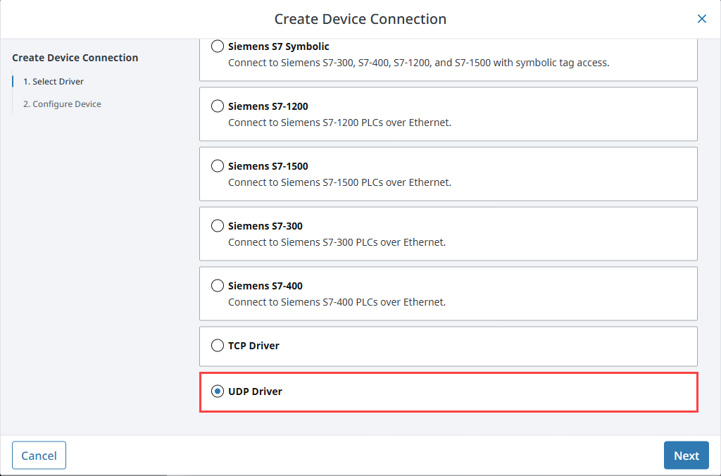

  3. Select UDP Driver from the list and click Next.

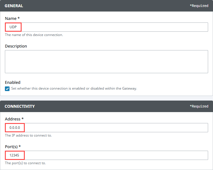

    • Name: The desired name for the device (e.g., UDP)
    • Port(s): The UDP port(s) to connect to, comma-separated. (e.g., 12345)
    • Address: The IP address of the device (e.g., 0.0.0.0 to listen on all interfaces)

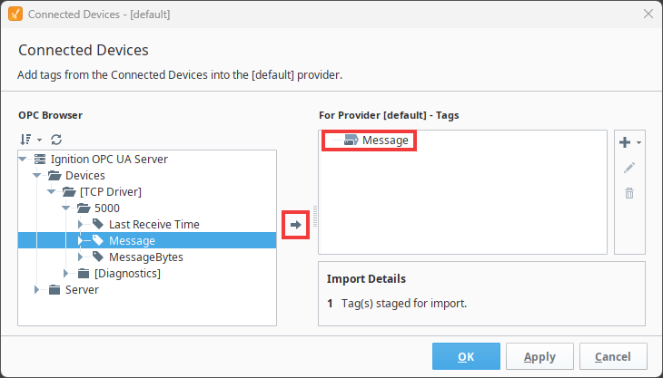

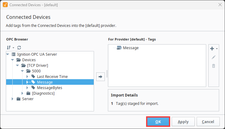

Once your TCP or UDP connection is set up, you can start browsing the driver for data points. The example below uses the TCP driver and assumes you have already connected to a valid port and IP address. For instructions on setting up a TCP driver connection, see Connecting to a TCP Device.

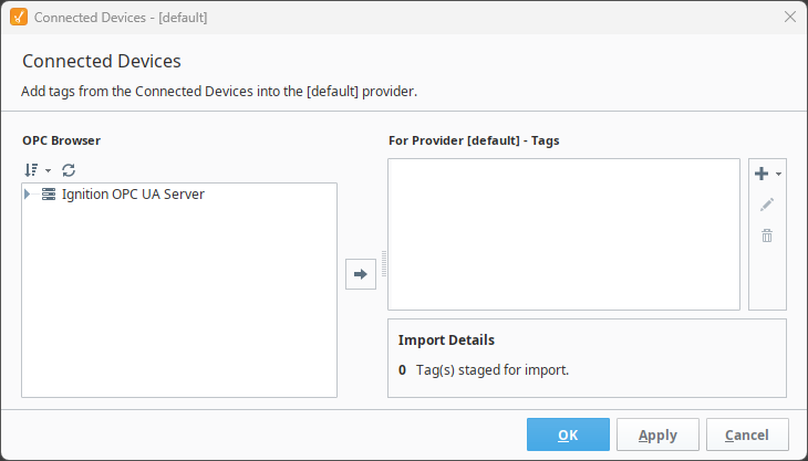

  1. In your Tag Browser, click on the Add Tag Browser Add Icon icon, then click on Browse Devices... Browse Devices Icon. The Connected Devices popup window will open.
    Address Browsing Step 1

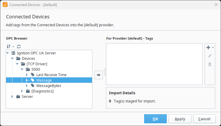

  2. Navigate to the tag you want to import. In this example, since we want to add the Message in port 5000, we'll go through Ignition OPC UA Server > Devices > [TCP Driver] > 5000 > Message.
    Address Browsing Step 2
  3. Select the tag or folder to import and add it to your Tag Provider by clicking on the Add Connected Devices Window Add Icon icon. This will stage the tag for when you are ready to import, in case you want to add any other tags or folders.
    Address Browsing Step 3
  4. Once you have added the tags and folders you want, click OK to add them to your Tag Browser.
    Address Browsing Step 4
Your data is now available to use in Ignition.
