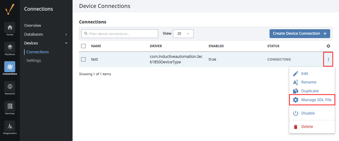

  1. Go to the Connections section of the Gateway Webpage.
  2. Select Devices > Connections.
    Connecting to a Device Step 2
  3. Click on Create Device Connection.

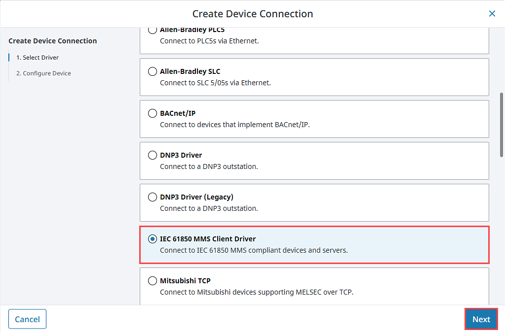

  4. Scroll down to select the IEC 61850 MMS Client Driver and click Next.
    Connecting to a Device Step 4
  5. Enter a desired name into the Name field. In this example, we will be entering test.
  6. Enter the IP address or hostname of the device you are connecting to in the Hostname field. All other default settings can be left as is.
  7. Click Create Device Connection. The Device Connections page now lists the IEC 61850 MMS Client Driver. The Status column will show Connected or Idle, depending on the status of the device.
  8. On the connected driver, test in this example, and expand the three dots menu and select Manage SDL File.

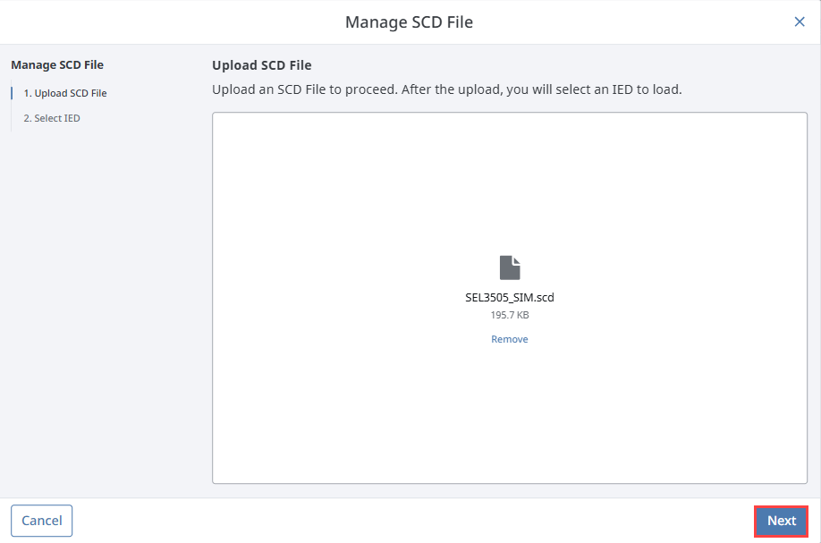

    Substation Configuration Description (SCD) files grant user control of transfer device descriptions and communication parameters. This file format is the only accepted System Configuration Language (SCL) file type. It is generally recommended to use an SCD file if you intend to limit the request size and visibility of access points during OPC browsing. This will effectively reduce the load against the substation device. Without an SCD file, any device connection restart will request all defined Logical Nodes from your defined IED for OPC browsing, which can become network-traffic heavy.
    However, because of how Ignition treats device attributes we recommend always using an SCD file, as it may not be possible to resolve associated quality or timestamp values without it.
    Connecting to a Device Step 8
  9. Locate your SCD file and drag it into the upload field or click the link to upload your file directly.
  10. Click Next.

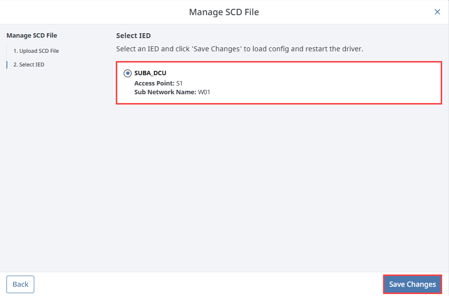

  11. Select the IED you want to request for reports.
    Connecting to a Device Step 12

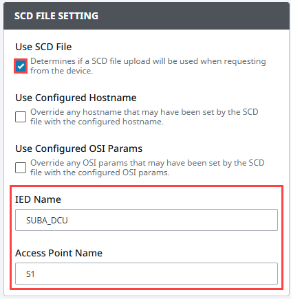

  12. Click Save Changes.
    info
    The Edit panel will now show the saved SCD file settings. Use SCD File will be checked, and IED Name and Access Point Name will match the selected upload config settings. You can use these settings to verify correct configuration or further tweak your SCD file.

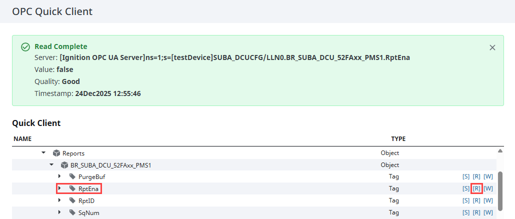

Use the OPC Quick Client to Confirm Report Statuses​
Once you have established a device connection, you may want to verify report availability before opening the Designer. The OPC Quick Client provides a convenient way to inspect IEC 61850 report statuses and troubleshoot report configuration directly from the Gateway at Connections > OPC > Quick Client. From there, browse the Ignition OPC UA Server and locate your IED under the Devices folder, where configured IEC 61850 device data is organized into the following folders:
  • Model: Contains logical nodes that can be directly polled for information.
  • Reports: Contains a folder for each report control block, and exposes report-related attributes that can be subscribed to.
  • Diagnostics: Contains diagnostic information that can help identify the status of various aspects of the configured device.
note
Subscribing to any report control block attribute causes Ignition to attempt to enable the associated report using the RptEna attribute. If a report cannot be enabled, the subscription will return a quality of Bad_OutOfService: The source of the data is not operational.
If you are unsure if a report is enabled, you can use the [R] read action on the RptEna attribute within the appropriate report control block folder under Reports. A value of false indicates the report is not currently enabled, while a value of true indicates the report is already enabled elsewhere and cannot be enabled again.
