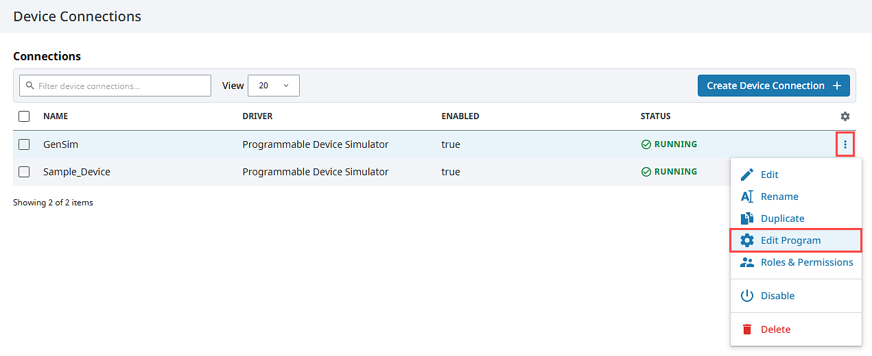

  1. On the Gateway, go to the Connections > Devices > Connections page.

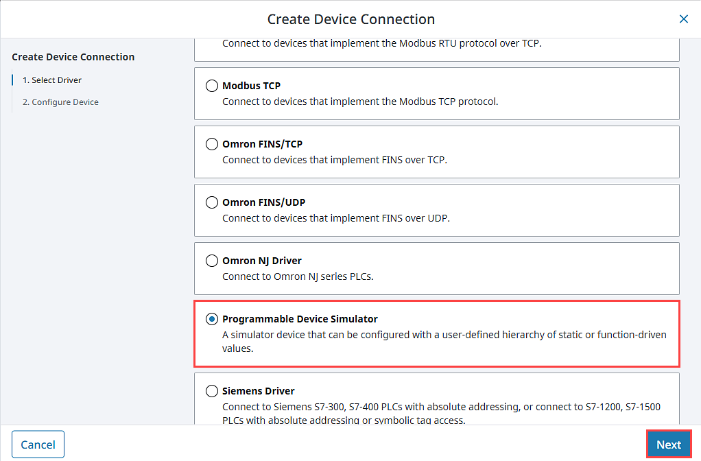

  2. Click on Create Device Connection.
  3. Select Programmable Device Simulator and click Next.

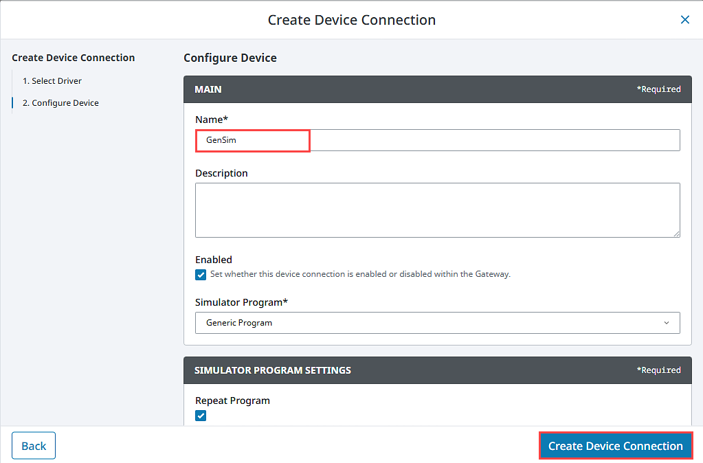

  4. Give the device a name (i.e., GenSim), and click Create Device Connection.
    Connecting to a Programmable Device Simulator Step 5
  5. The page will refresh and you'll see your device was successfully created with a status of "Running". Now you can set the program for the simulator by expanding the three dots menu and selecting Edit Program.

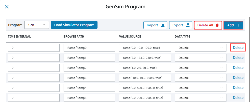

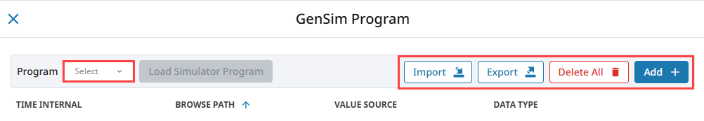

  6. Edit instructions by using the Import, Export, Delete All, and Add buttons. These instructions determine what tags get made, and what their values are. Additionally, you can load a predefined program from the Program dropdown and click Load Simulator Program.
    Connecting to a Programmable Device Simulator Step 7
  7. Once you have some instructions added, click Save Changes.
